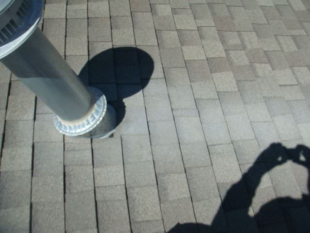

mridgeelk Posted August 5, 2012 Report Share Posted August 5, 2012 The furnace connected to this flue has about 60% of the combustion air that it requires. Would this cause the white stains on the shingles due to improper combustion? The stains are similar to ones typically found under swamp coolers that leak or have an improperly adjusted float. Click to Enlarge 45.68 KB Link to comment Share on other sites More sharing options...
Nolan Kienitz Posted August 6, 2012 Report Share Posted August 6, 2012 Possibly the chemical composition of the vent stack just leaching down the shingles. Link to comment Share on other sites More sharing options...
Marc Posted August 6, 2012 Report Share Posted August 6, 2012 I was waiting for Mr O to chime in because he's got a crystal clear description for it...anyway...a reduced draft is allowing flue gas temps to drop too much resulting in it's condensation before it can exit the flue. The condensation is acidic and reacts with the zinc in the galvanizing to produce zinc oxide which is solid at ambient temps and white in color. So mridgeelk is right on the money with his diagnosis of inadequate flue draft. Marc Link to comment Share on other sites More sharing options...

mridgeelk Posted August 6, 2012 Author Report Share Posted August 6, 2012 Thank you, Marc. Ed Link to comment Share on other sites More sharing options...
John Kogel Posted August 6, 2012 Report Share Posted August 6, 2012 I agree, the furnace needs to be checked out. Ed, was that elk on your property? A friend offered to help a relative hunt down an elk cow. This guy had a tag for a cow, not many allowed in any given year. Every time they got close to the herd, the greenhorn would spook the herd and they'd be gone. All except the bull, who would be standing there watching them, but he was not fair game. After about a week, they finally got their cow, in the local farmer's field. Farmer called them up, "Come and get yer stinkin' elk" and hauled it to the road for them with the tractor. Farmers up here hate elk. Link to comment Share on other sites More sharing options...

John Kogel Posted August 6, 2012 Report Share Posted August 6, 2012 John, I raised elk for many years. Now I am down to a few old cows and no stinkin' bulls. An elk bull in the rut puts any dairy bull (Holstein, Ayrshire etc.) to shame as far temperament and destructiveness. I'm impressed, Ed. We had a milk cow when I was a kid, but I couldn't raise a chicken if I had to. Coons got the last couple we had, since they were roosting in a tree instead of in their pen. I did fish a buck deer out of a swimming pool once. Almost got spiked in the process. I wouldn't want to tell a bull elk he can't have any cow today. [] Oh, yeah, good call on the furnace. Link to comment Share on other sites More sharing options...
