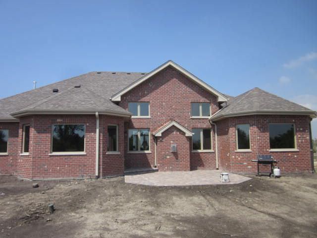

Mike Lamb Posted August 1, 2012 Report Share Posted August 1, 2012 How difficult will it be to clean mortar from brick that has been on for probably 6 - 7 months? This sloppiness is just about everywhere. Click to Enlarge 48.95 KB Click to Enlarge 45.97 KB Link to comment Share on other sites More sharing options...

Tom Raymond Posted August 1, 2012 Report Share Posted August 1, 2012 Had they cleaned it before they removed the scaffold it would have come right off with distilled white vinegar and a stiff bristle brush. Now they'll need to use muriatic acid. A couple of laborers could do it in a day or so. Link to comment Share on other sites More sharing options...
