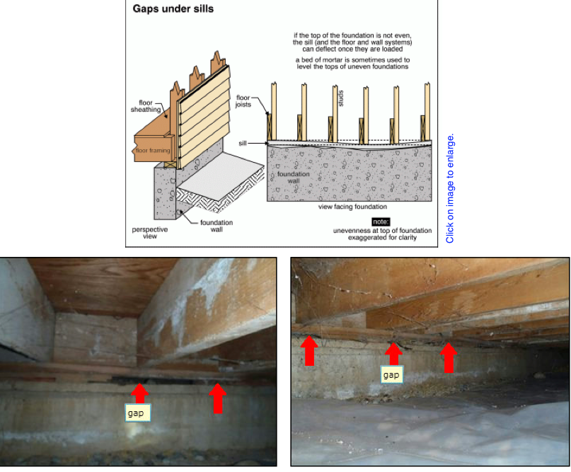

scubaryan Posted July 2, 2012 Report Share Posted July 2, 2012 I am hoping somebody with the right expertise might be able to address some concerns I had with a recent home inspection of a house my wife and I are looking to buy. I will write what the inspector wrote for the FLOORS/SILLS Condition: -Gap under sills There has been some damage to the sill plate in the past under the east living room. It appears that the sill plate was originally below grade and most likely rotted out. A poor attempt at a repair was made as the sill plate is elevated with little support in some areas as well as being very wavy. I recommend that you do further evaluation to determine if further repairs will be necessary. Location: Crawl Space Task: Further Evaluation Needed Time: Immediate I greatly appreciate any input! I would like to know if this is a deal breaker or if this is easily fixable. And if it does require a professional what would a rough estimate be for cost? I live in British Columbia, Canada. The house was built in 1984. The rest of the house is quite structurally sound. The one section/corner of the house sitting above these sill gaps was found to have level/straight floor inside the house. So no sagging yet. Pictures: Click to Enlarge 621.3 KB Click to Enlarge 220.23 KB Click to Enlarge 695.3 KB Click to Enlarge 717.25 KB Link to comment Share on other sites More sharing options...
Jim Katen Posted July 2, 2012 Report Share Posted July 2, 2012 I hate inspection reports that have crap like that in them. The inspector should be able to look at an issue like this and say either, "Yes, this is a problem that you should have fixed," or, "No, this problem doesn't merit repair." Instead, you get the "further evaluatioon needed" wuss dance. You're pictures aren't showing up yet. Without them, I can't offer any meaningful advice. However, I suspect that the worst case scenario is that someone might have to drive some steel shims under your mud sill. Link to comment Share on other sites More sharing options...

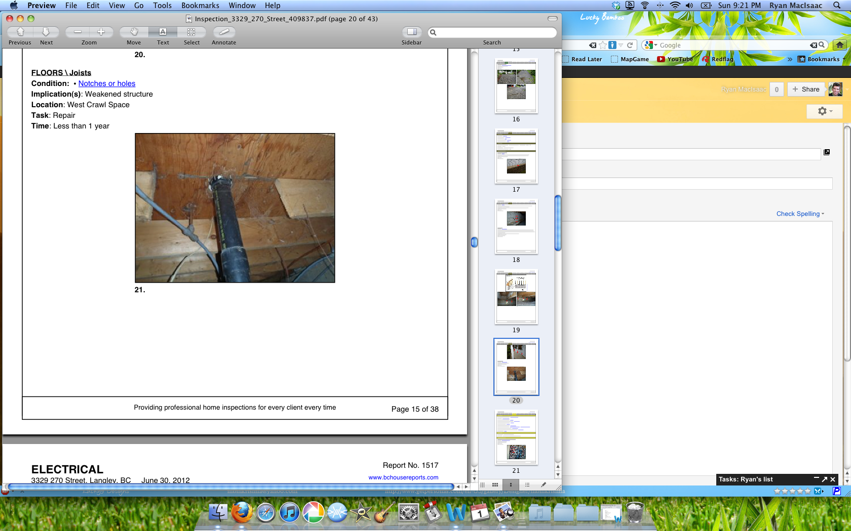

Marc Posted July 2, 2012 Report Share Posted July 2, 2012 Given the limitations of the photos, there's several issues I can make out. The gap between the foundation and the joists leaves only the band joist to support the joist. Floor joists should bear directly upon the foundation walls. Install enough support to fill the gap and to take the load off of the band joist. The exterior walls seem to be sitting directly on the concrete porch. The footprint of those walls should have been elevated so that rainwater doesn't come into contact with the sills and perhaps even enter the house by seeping beneath them. I don't know what you can do about it, short of taking the wall out and doing it over. Headers should be installed where a section of floor joist has been removed. This will restore support to the joist ends. Additional spot foundations and piers may be needed directly beneath the joist ends/headers depending on how much weight is on the floor from above. Last but not least...Your inspection report is worthless. Don't depend on it anymore. Go online and read sample report from other inspectors in your area then hire the best one. No more 'recommend further evaluation' crap. It's not hard to notice well written reports that tell you the basics: what is it, what does it mean and what to do about it. Credits to Kurt M for that last line. It's the foundation of good report writing. Marc Link to comment Share on other sites More sharing options...
John Kogel Posted July 3, 2012 Report Share Posted July 3, 2012 To answer your questions 1) No, it is not easily fixable. As I said above, crawlspace repairs are very expensive because of poor access and general discomfort. You will need to pay a lot to have this repair done properly. 2) It appears from the evidence so far, that this house was not given a proper foundation to begin with. The grade is too close to the top of the foundation perimeter wall. The crawlspace was never excavated for proper access to all the corners under the house, and the vapour barrier was not properly installed. So the problems will not be over, even after this rotted sill problem is fixed. 3) Some hack artist has cut a joist and done nothing to compensate for it. Danger. There may be some hidden problems that haven't been discovered yet, such as where framing was cut for this plumbing pipe in the walls above, incorrect venting, wiring botch-ups, etc. This house is trouble. I think you should be asking your inspector these questions, BTW. Marc is being a little harsh about the report. I think it is a Carson Dunlop format. The report gives you the facts of what and where, and says to repair. We can't design the repair if it is not in our field of expertise. The HI is saying "Get estimates from a builder" in a round about way. Let me put it in perspective. A handyman working on his own time can repair just about anything, but if you intend to pay someone to grovel in the dirt under that POS for you, be prepared for some financial setbacks. Link to comment Share on other sites More sharing options...

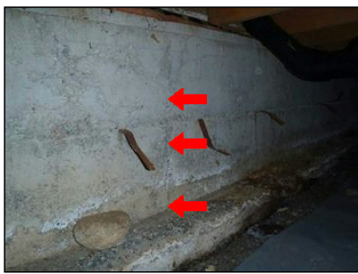

kurt Posted July 3, 2012 Report Share Posted July 3, 2012 OK, saw the blue vinyl. Zip the siding, drive some shims in under the sill, treat the area, put the siding back. If the concrete is placed up over the sill, that's a problem. Is the last pic with the 3 arrows the area the sill is damaged? Link to comment Share on other sites More sharing options...

Jim Katen Posted July 3, 2012 Report Share Posted July 3, 2012 Drive some steel shims under the mud sill below each joist. Install some headers at the cut joist. This is simple stuff, it's not a big deal. What's the second picture with the three horizontal arrows supposed to be illustrating? Link to comment Share on other sites More sharing options...

Mike Lamb Posted July 4, 2012 Report Share Posted July 4, 2012 The report isn't worthless. All the comments here are based on the inspector's photos which are pretty good, and I'm guessing all of Scuba's comments came from the inspector's report verbatim so those comments also have value as well. It would have been nice if he told you this is not a big deal but he chose the safe, wishy-washy route which has led to your angst. He recommended further evaluation and you are getting it here. And I like the diagram. It gives the buyer who may be wholly ignorant of house framing an idea of what is going on. I would have erased most of the text. I would like to know if this is a deal breaker or if this is easily fixable. It's an easy fix. And if it does require a professional what would a rough estimate be for cost? $700 - $1200 Link to comment Share on other sites More sharing options...

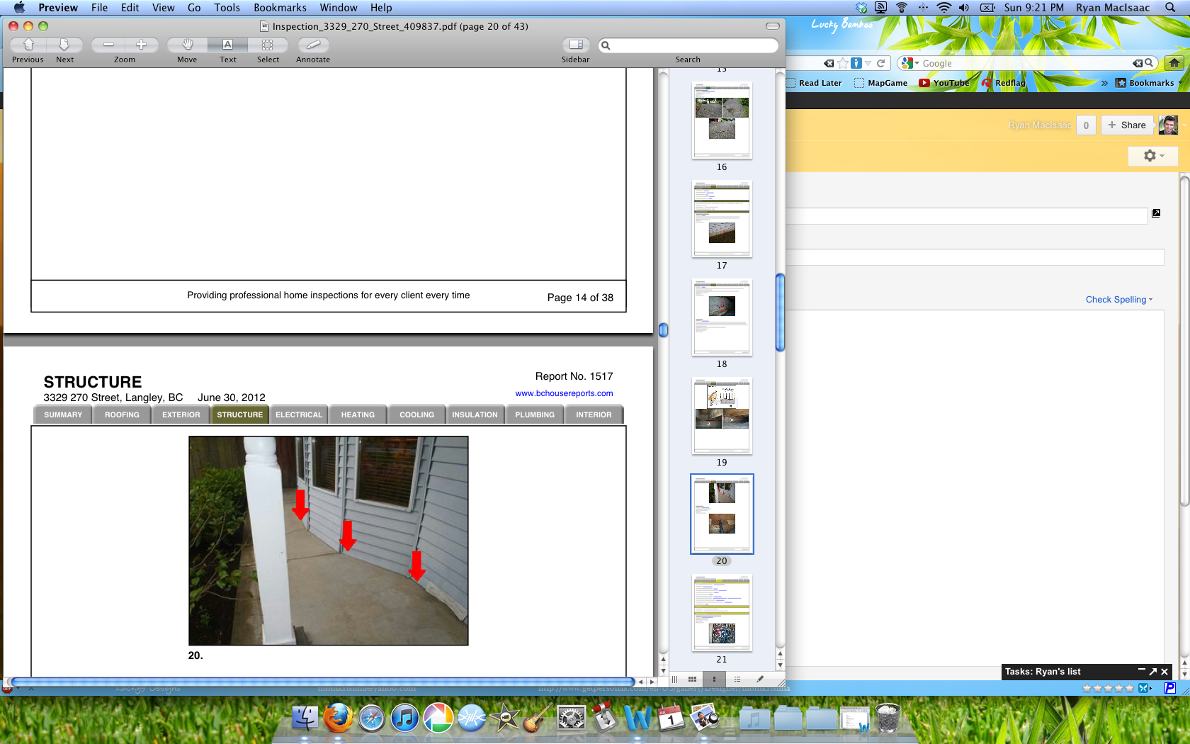

John Kogel Posted July 4, 2012 Report Share Posted July 4, 2012 Hey, what about the sidewalks up against the siding? Is that an easy fix too? [] Good chance the repair guy will drive a bit of plywood or OSB under that sill and call it done. What about anchor bolts? Insurance companies are asking for anchor bolts nowadays. Earthquake insurance is probably void without them, but you still pay the full premium. Link to comment Share on other sites More sharing options...

Jim Katen Posted July 4, 2012 Report Share Posted July 4, 2012 Hey, what about the sidewalks up against the siding? Is that an easy fix too? [] A few minutes with a jack hammer. Done. Seriously, I see that condition daily. It causes problem in 1 out of a few hundred houses, especially when it's under cover as the one in the original post seems to be. If the issue is a real problem, there are a half dozen ways to address it. If it's not a real problem, go on with life. Good chance the repair guy will drive a bit of plywood or OSB under that sill and call it done. Possibly. That's why I get more specific in my recommendations. I know it's against home inspection canon and all that, but I actually say stuff like, "Put steel shims under the sill. Don't accept wooden ones." So sue me. What about anchor bolts? Insurance companies are asking for anchor bolts nowadays. Earthquake insurance is probably void without them, but you still pay the full premium. We can play what's-wrong-with-this-picture games all day. Link to comment Share on other sites More sharing options...
