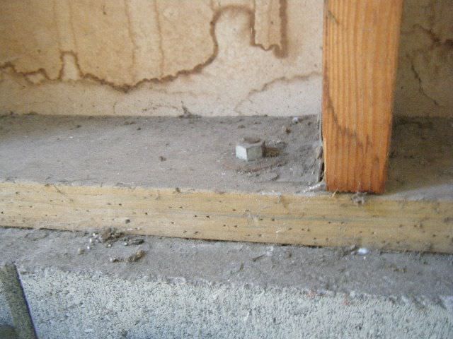

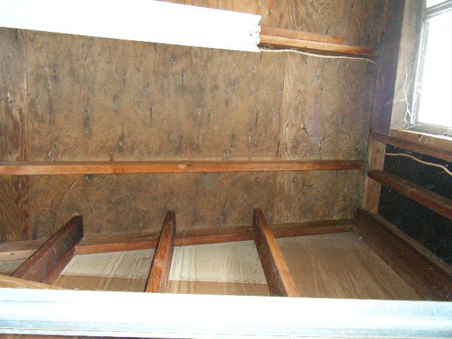

Denray Posted June 30, 2012 Report Share Posted June 30, 2012 I was looking at an add on garage today that had an outside wall around 8ft high that had mortar laid horizontally about every 3 courses. The framed wall above was anchored into the top of the the CMU's via grout filled top courses, but seemed really strange. Lots of efflorescence on the wall and moisture stains on the drywall above. I think the garage was being used as a grow room at one time. So, can CMU's be put up without mortar between them with the idea that maybe they are grout filled? And maybe there is rebar in them? And maybe there is a tooth ferry? Click to Enlarge 64.27 KB Click to Enlarge 61.21 KB Link to comment Share on other sites More sharing options...

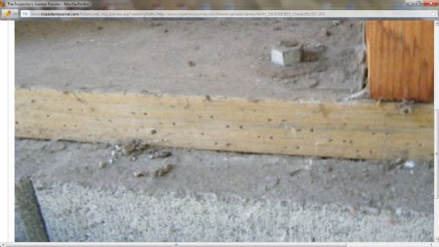

Denray Posted June 30, 2012 Author Report Share Posted June 30, 2012 This is Humboldt County. I think there was a grow going on at one time. The plywood roof sheathing had a light blackness on it. There were some weird electrical outlet placements, etc. Yes we get a quake wallop once in a while. It's definitely a non permitted kind of build. Should I punt to a structural engineer? Click to Enlarge 62.56 KB I didn't see those holes in the sill till I looked at the photo. Click to Enlarge 58.89 KB Link to comment Share on other sites More sharing options...
John Kogel Posted June 30, 2012 Report Share Posted June 30, 2012 It's not framed right, either, so yes, I would. (I'd want to see a top plate instead of studs notched into a rafter.) Maybe they grew tropical plants for the local garden shop? [] Link to comment Share on other sites More sharing options...
BADAIR Posted June 30, 2012 Report Share Posted June 30, 2012 holes appear man made Click to Enlarge 38.48?KB Link to comment Share on other sites More sharing options...
