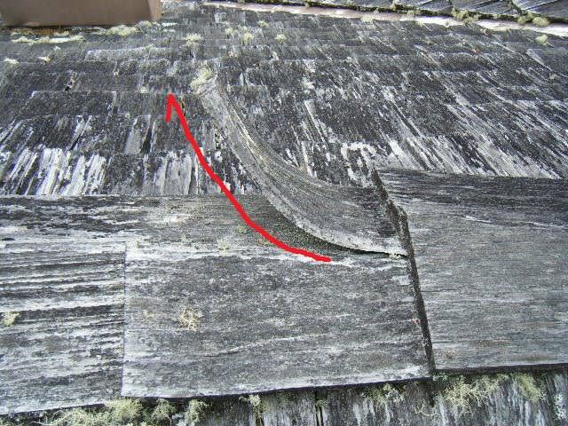

Denray Posted June 28, 2012 Report Share Posted June 28, 2012 There were about 10 shakes like this on this roof. What makes them do this? Click to Enlarge 113.6 KB Link to comment Share on other sites More sharing options...

Bill Kibbel Posted June 28, 2012 Report Share Posted June 28, 2012 There were about 10 shakes like this on this roof. What makes them do this? Too much exposure, nailed too high, flat grain and/or those shakes had considerably more sapwood than the other shakes of mostly heartwood. Link to comment Share on other sites More sharing options...
John Kogel Posted June 29, 2012 Report Share Posted June 29, 2012 There were about 10 shakes like this on this roof. What makes them do this? Too much exposure, nailed too high, flat grain and/or those shakes had considerably more sapwood than the other shakes of mostly heartwood. Right. The top quality shake wood is scarce, so they are picking up wood that in the past would have gone for sawn shingle or siding. That is a pretty extreme warp tho. Some of the other curled shakes may have been split from the same block, probably a butt end. Good shake wood comes from old growth cedar. It is a thing of the past now, all gone. Link to comment Share on other sites More sharing options...

Tom Raymond Posted June 29, 2012 Report Share Posted June 29, 2012 I don't think the curls are that big of a problem. They'll be knocked off when the rest of the cover is mowed. That cover is whooped. Link to comment Share on other sites More sharing options...
