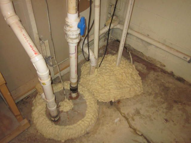

Mike Lamb Posted May 18, 2012 Report Share Posted May 18, 2012 They don't call it Great Stuff for nothing. Click to Enlarge 39.53 KB Link to comment Share on other sites More sharing options...

Erby Posted May 18, 2012 Report Share Posted May 18, 2012 "The sewage ejector pump lid and sump pump lids are sealed in place with Great Stuff Expanding Foam. While this provides an air seal, you'll have a difficult time removing it when maintenance or repairs to the pumps are needed. In addition, a rubber "Fernco Fittings" is in use inside the residence on the sewage ejector pump piping. The only "Fernco Fittings" that should be used inside a residence are supposed to be steel jacketed. This one isn't. It should be replaced with a steel jacketed "Fernco Fitting" Address is on my website. Link to comment Share on other sites More sharing options...
kurt Posted May 18, 2012 Report Share Posted May 18, 2012 POI.........Fernco's are flexible PVC, not rubber. I still think you should get the money, though. Link to comment Share on other sites More sharing options...
gtblum Posted May 18, 2012 Report Share Posted May 18, 2012 POI.........Fernco's are flexible PVC, not rubber. I still think you should get the money, though. Not so fa$t! Erby claims it to be "Great Stuff" brand. How did you identify the product, sir? Link to comment Share on other sites More sharing options...
Erby Posted May 18, 2012 Report Share Posted May 18, 2012 C'mon Gary. How do you think. Four senses: Sight, touch, smell, taste. if you try this though remember to spit it out. It'll give you diarrhea, even just a little tiny bit swallowed. Link to comment Share on other sites More sharing options...
Denray Posted May 18, 2012 Report Share Posted May 18, 2012 Erby, is that because the rubber one would be subject to cracking and leaking? Do you have a picture of a steel jacketed one? Link to comment Share on other sites More sharing options...

Denray Posted May 21, 2012 Report Share Posted May 21, 2012 Fernco heaven in that shot John. Got it, PVC! So the steel wrap is needed in cases where there will be pressure, otherwise not? Link to comment Share on other sites More sharing options...
ejager Posted May 22, 2012 Report Share Posted May 22, 2012 I see on the Fernco site that both the regular and the steel wrapped fittings are only tested for 4.3 PSI. The steel wrapped fittings are designed for "resistance to heavy earth loads and shear forces, and provides improved pipe alignment." I see both fittings installed so frequently I never suspected they were so rated. Thanks to TIJ for the things I learn here. Link to comment Share on other sites More sharing options...
