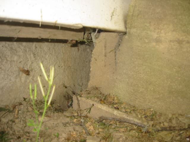

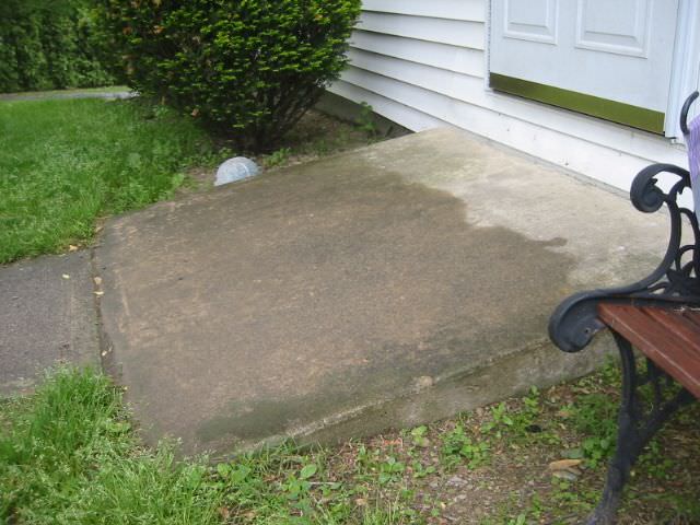

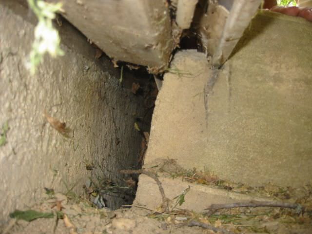

Inspectorjoe Posted May 15, 2012 Author Report Share Posted May 15, 2012 The exterior detailing wasn't much of a step up from a big box store garden shed. And the fun didn't end with the work done at the factory: Click to Enlarge 66.41 KB Click to Enlarge 48.36 KB Click to Enlarge 49.4 KB Link to comment Share on other sites More sharing options...
