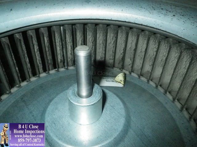

Erby Posted May 6, 2012 Report Share Posted May 6, 2012 I had a gentleman come up to my vehicle, he saw my signs and sued if I had a minute. Lots of liability in this business when they sue for seeing your signs! Must have some really UGLY signs! [:-monkeyd[:-monkeyd[:-monkeyd My Pentax W90 camera can get into almost any filter slot to get a shot of the coils. Blower Fan pics are easy. Click to Enlarge 66.67?KB Click to Enlarge 59.49?KB The main blower fan blades are dirty and the coils are partially blocked with crud. This impedes the operating efficiency of the unit. Get a good heating and cooling contractor to pull out the coils and fan, clean them and reinstall them. On the topic of heat exchangers: ====================== Note: Furnace heat exchangers are not readily accessible. Disassembling the furnace, which should only be done by a heating and cooling contractor, is necessary for proper inspection of the heat exchanger. Disassembling the furnace is beyond the scope of this inspection. ====================== I used to say HVAC Contractor until I remember back to the days when I didn't have a single dang clue what the heck HVAC stood for. - Link to comment Share on other sites More sharing options...
