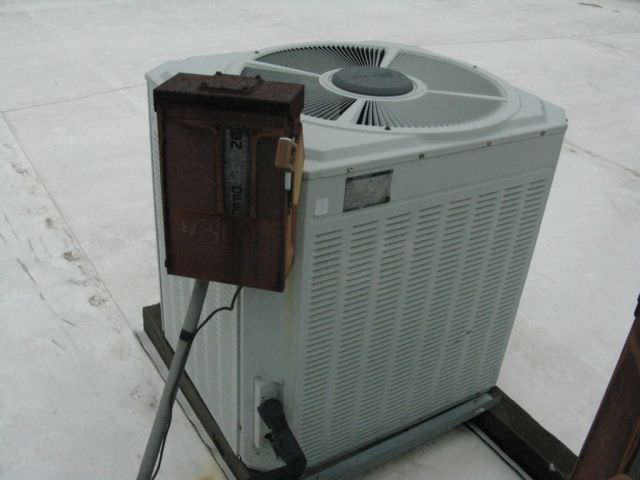

MPdesign Posted April 22, 2012 Report Share Posted April 22, 2012 TPO and EPDM | How to visually tell the difference? Can someone please answer this and maybe post pictures? [?[^] THANK YOU!!!!! Link to comment Share on other sites More sharing options...
hausdok Posted April 22, 2012 Report Share Posted April 22, 2012 The TPO is shiny and feels and looks exactly like a swimming pool liner with heat-welded seams and the EPDM looks and feels exactly like black inner tube material. ONE TEAM - ONE FIGHT!!! Mike Link to comment Share on other sites More sharing options...
Jim Katen Posted April 22, 2012 Report Share Posted April 22, 2012 TPO and EPDM | How to visually tell the difference? Can someone please answer this and maybe post pictures? Start with the color. Although TPO is available in a dozen different colors, it's usually white. EPDM can be either black or white, but black is far more common. EPDM is rubber. It feels exactly like an inner tube on a tire. TPO is plastic. It's harder and less stretchy. EPDM has a matte surface. TPO has a shiny, slick surface. EPDM seams are cemented together. TPO seams are heat welded. Link to comment Share on other sites More sharing options...
kurt Posted April 22, 2012 Report Share Posted April 22, 2012 No one described how to tell whether it's TPO or PVC. That's a little trickier. Link to comment Share on other sites More sharing options...
Jim Katen Posted April 22, 2012 Report Share Posted April 22, 2012 No one described how to tell whether it's TPO or PVC. That's a little trickier. No one asked. It's a lot trickier. Aside from the fact that TPO is *usually* slicker (not always), I look for a label somewhere. The TPO flashing boots nearly always have "TPO" stamped onto them somewhere. The most popular PVC product in my area is Durolast and it almost always has DL stamped on the seams along with the installation date. Also, with some products, not all, the amount of plastic on top of the scrim is less than the amount of plastic below it with TPO. Whereas, with PVC, the scrim is right in the middle. Link to comment Share on other sites More sharing options...
kurt Posted April 22, 2012 Report Share Posted April 22, 2012 That's (more or less) what I do. I still can't tell lots of times, and have to ask. I hate asking. Link to comment Share on other sites More sharing options...
MPdesign Posted April 22, 2012 Author Report Share Posted April 22, 2012 So, I am thinking this is TPO because: whiter than off-white doesn't look cemented looks like clean seams correct? Click to Enlarge 37.86 KB Click to Enlarge 27.51 KB Link to comment Share on other sites More sharing options...
kurt Posted April 22, 2012 Report Share Posted April 22, 2012 It's why I brought it up; it's really hard to tell, especially from a pic. Some of the Durolast jobs I see have joints as clean as TPO. Link to comment Share on other sites More sharing options...
hausdok Posted April 22, 2012 Report Share Posted April 22, 2012 No one described how to tell whether it's TPO or PVC. That's a little trickier. I don't try and figure it out; I tell 'em it's either TPO or PVC and if they're interested in knowing which they should find out who installed it and give 'em a call. I don't really care. If it's right it's right; if it's wrong I write it up and let the roofing contractor figure it out. ONE TEAM - ONE FIGHT!!! Mike Link to comment Share on other sites More sharing options...
MPdesign Posted April 22, 2012 Author Report Share Posted April 22, 2012 Single ply membrane it is - for now. I will start looking at flashing boots for TPO and seams for DO! Thank you gentlemen. Link to comment Share on other sites More sharing options...
kurt Posted April 22, 2012 Report Share Posted April 22, 2012 No one described how to tell whether it's TPO or PVC. That's a little trickier. I don't try and figure it out; I tell 'em it's either TPO or PVC and if they're interested in knowing which they should find out who installed it and give 'em a call. I don't really care. If it's right it's right; if it's wrong I write it up and let the roofing contractor figure it out. ONE TEAM - ONE FIGHT!!! Mike Yeah, but it's better to be right. You know how it is; if I call it the wrong thing, then the goons get all excited about me being wrong. I hate giving people ammunition. Link to comment Share on other sites More sharing options...
