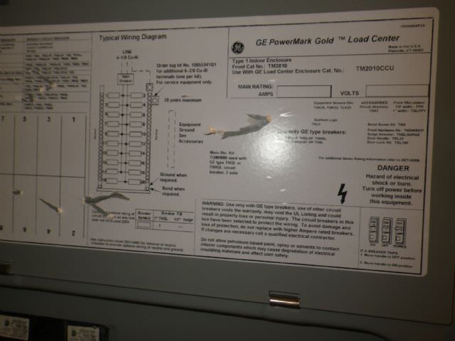

Mark P Posted April 15, 2012 Report Share Posted April 15, 2012 I am just wanting to confirm that this panel (GE PowerMark Gold - TM 2010) does not permit the use of tandum breakers and it is in fact overfull. Click to Enlarge 77.36 KB Click to Enlarge 92.54 KB Thanks You Click to Enlarge 38.04 KB Link to comment Share on other sites More sharing options...

Mike Lamb Posted April 15, 2012 Report Share Posted April 15, 2012 http://www.ashireporter.org/articles/ar ... px?id=2047 You are right. Tandems should not be used in this panel. Link to comment Share on other sites More sharing options...

Inspectorjoe Posted April 15, 2012 Report Share Posted April 15, 2012 "20 poles maximum" is printed on the label. It's too bad all panelboards don't contain that info. Link to comment Share on other sites More sharing options...

Charlie R Posted April 15, 2012 Report Share Posted April 15, 2012 You are correct, no tandems allowed. Panel is labeled 20 pole max (and it is also indicated by the model number), I count 26 Link to comment Share on other sites More sharing options...

Norcal Posted April 16, 2012 Report Share Posted April 16, 2012 The twin breakers installed in the GE, Goverment Electric panel are not GE, & I doubt they are UL classified to be used in one. GE twin breakers are peculiar to GE & they will not fit a non-GE manufactured panel. Link to comment Share on other sites More sharing options...
Jim Katen Posted April 16, 2012 Report Share Posted April 16, 2012 The twin breakers installed in the GE, Goverment Electric panel are not GE, & I doubt they are UL classified to be used in one. GE twin breakers are peculiar to GE & they will not fit a non-GE manufactured panel. Good point. Those are Siemen's breakers - almost certainly not classified for use with GE. Link to comment Share on other sites More sharing options...
