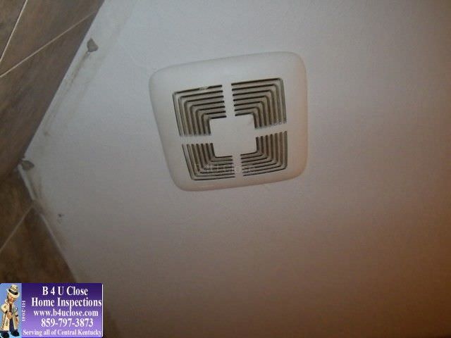

Erby Posted April 12, 2012 Report Share Posted April 12, 2012 Is there an easy way to tell if a fan is rated for installation directly inside the shower compartment without tearing it apart? Click to Enlarge 30.44 KB Link to comment Share on other sites More sharing options...
Jim Katen Posted April 12, 2012 Report Share Posted April 12, 2012 Is there an easy way to tell if a fan is rated for installation directly inside the shower compartment without tearing it apart? I doubt that tearing it apart will tell you anything. I think I'd just recommend that it be GFCI protected and be done with it. Link to comment Share on other sites More sharing options...
Brandon Whitmore Posted April 13, 2012 Report Share Posted April 13, 2012 I'm pretty sure I've always had to pull the cover to read what was needed. Link to comment Share on other sites More sharing options...
