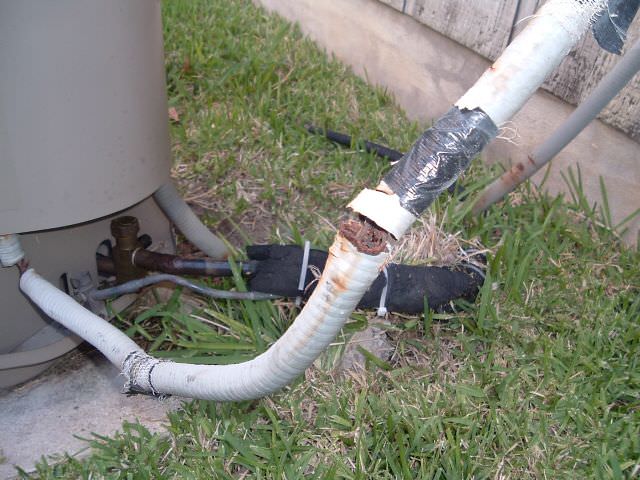

mdramis Posted June 7, 2005 Report Share Posted June 7, 2005 Ok guys this is a zinsco panel in my own house. I'm new at this so tell me everyting I need to know about it and don't hold back. The other pic is the junction box to the condensing unit and the conduit, or should I say what's left of it going to the condensing unit. Download Attachment: 2005_0606Image0015.JPG 481.83 KB Download Attachment: 2005_0606Image0014.JPG 489.88 KB Download Attachment: 2005_0606Image0013.JPG 471 KB Link to comment Share on other sites More sharing options...
inspectort Posted June 7, 2005 Report Share Posted June 7, 2005 The 2 worse panels for an electrician or an inspector to see on a job is a Zinsco or a Federal Pacific. The problem is that the breaker become lose and begins arcing, building up heat and becoming even more lose. This one looks in pretty good condition. But my suggestion would be to replace it as soon as possible. If you have to replace one of those 50amp breakers, if you can find one, your probably going to pay close to a hundred dollars for it. As for the condensor wiring, I think it goes without saying, repair or replace. Looks like its been hit with the lawnmower or the weed eater a few too many times. Good luck. T. Link to comment Share on other sites More sharing options...

Jim Katen Posted June 8, 2005 Report Share Posted June 8, 2005 Originally posted by mdramis Ok guys this is a zinsco panel in my own house. I'm new at this so tell me everyting I need to know about it and don't hold back. The other pic is the junction box to the condensing unit and the conduit, or should I say what's left of it going to the condensing unit. It's a nasty old panel. Replace it. Of course you need to replace the compressor wiring as well. If you want to know more about Zinsco panels, search past posts on this forum. There ought to be plenty to read. - Jim Katen, Oregon Link to comment Share on other sites More sharing options...
