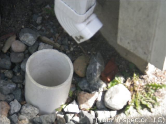

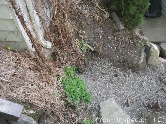

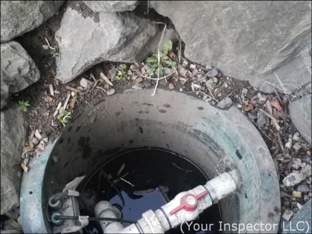

hausdok Posted April 5, 2012 Report Share Posted April 5, 2012 Continuing with your theme of some folks baffle me.... Did a one of two townhomes in a Duplex two days ago where the roof runoff for the entire building goes to one tank and is pumped up to the storm sewers in the street about 40ft. above when that tank fills; and where each unit has its own waste holding tank that also pumps up to the street above to the sanitary sewer when the tank fills. Nice setup with alarms neatly arrayed nearby. Except....none of the pumps are working. When the alarms went off to warn the occupants that the tanks were full and the pumps weren't working, did they call a plumber? Hell no! They just turned the alarms off and disconnected the downspouts from their receivers so that the storm water cistern wouldn't fill and I have no idea what they've been doing to prevent the waste tank from overflowing. The bolts and gaskets are missing from every tank lid. The tanks are placed on a hillside directly in the path of the runoff from a house up the hill that has a downspout eroding a chunk out of the lot. Runoff is washing dirt and stones into the tanks. Did that stop the pump? Maybe, maybe now; however, those pumps probably aren't designed to chew up lots of condoms and ladies feminine products. How they didn't overflow onto the ground is beyond me, and what possessed the morons that live in that building to open those tanks Click to Enlarge 49.61 KB Click to Enlarge 39.19 KB Click to Enlarge 94.13 KB Click to Enlarge 74.24 KB Click to Enlarge 66.34 KB Click to Enlarge 67.02 KB ONE TEAM - ONE FIGHT!!! Mike Link to comment Share on other sites More sharing options...

hausdok Posted April 5, 2012 Report Share Posted April 5, 2012 Nah, Owners, both of them. The owner of the unit I inspected wasn't there but the owner of the adjacent unit came home. I'd found her tank at the other corner of the house, also with no bolts and filled nearly to the brim with stuff that looks like the last photo above - except no condoms. She got all misty eyed when I asked her if she knew the other owner and said, "Oh yes, we're very good friends." Ooooooo....K. I asked her why the tank lids were unbolted and she hadn't a clue. She assured me that if they were backing up the alarms would go off. "Not if they're turned off, which they are," I told her, whereupon she was either really surprised or is a really good actress, so I have to figure that Romeo was the idiot. ONE TEAM - ONE FIGHT!!! Mike Link to comment Share on other sites More sharing options...
