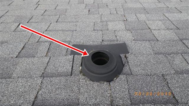

Robert Jones Posted March 23, 2012 Report Share Posted March 23, 2012 I say yes. Just seems to be such a large opening where the cast iron vent stack is. The just put a rubber boot around it. Click to Enlarge 73.97 KB Link to comment Share on other sites More sharing options...
Brandon Whitmore Posted March 23, 2012 Report Share Posted March 23, 2012 Vent must extend at least 6" above the roof line-- it's wrong and needs to be fixed. Link to comment Share on other sites More sharing options...
hoosier inspector Posted March 23, 2012 Report Share Posted March 23, 2012 Depends where you're at. Most codes call for stacks to protrude anywhere from 6"-12". Link to comment Share on other sites More sharing options...
Garet Posted March 23, 2012 Report Share Posted March 23, 2012 Hard to tell in the photo, but it looks like the pipe ends about 2" below the top of the rubber boot? Link to comment Share on other sites More sharing options...
Robert Jones Posted March 23, 2012 Author Report Share Posted March 23, 2012 Thanks guys. I had called it and yes, the actual cast iron is about 2" below the rubber boot. Link to comment Share on other sites More sharing options...
