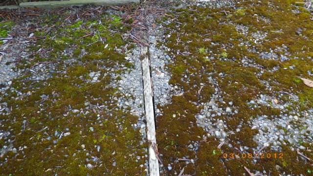

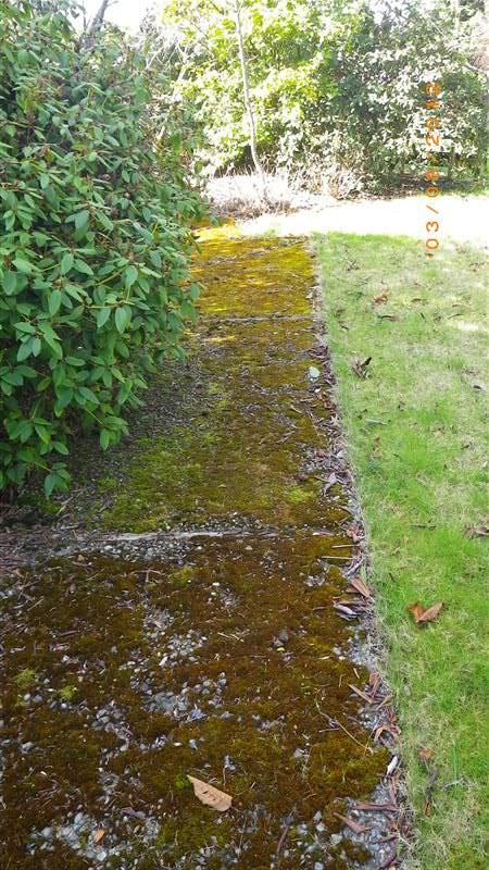

Robert Jones Posted March 9, 2012 Report Share Posted March 9, 2012 Curious as to opinions on how to clean this moss buildup from this aggregate walkway. Would a strong pressure washing deteriorate the surface? Click to Enlarge 85.6 KB Click to Enlarge 126.22 KB Link to comment Share on other sites More sharing options...
Jim Katen Posted March 9, 2012 Report Share Posted March 9, 2012 Sprinkle some moss-killing granules on it now & again in May. Let the granules do their thing. Then sweep it up with a corn broom this summer. Link to comment Share on other sites More sharing options...

Marc Posted March 9, 2012 Report Share Posted March 9, 2012 1 cup Clorax per gallon of water. Just apply it with a watering can. Wouldn't that kill it? I used the same method and solution to clean the Gloeocapsa magma from my neighbor's roof before he put his house on the market a few months ago. Worked great. No equipment needed. Home inspector didn't say a thing about the roof although I knew it was an EOL. Marc Link to comment Share on other sites More sharing options...
kurt Posted March 9, 2012 Report Share Posted March 9, 2012 With the right tip and angle of attack, a pressure washer would work great. Blow it all over on the neighbors lawn. Link to comment Share on other sites More sharing options...
John Kogel Posted March 9, 2012 Report Share Posted March 9, 2012 In the land of man vs moss, I recommend a full scale chemical assault. There's a lot of info here, more than you want to know about moss: http://bryophytes.science.oregonstate.e ... m#potasalt That walkway looks a bit like my lawn. That's the part that never needs mowing. [] Link to comment Share on other sites More sharing options...
skyavenuerealty Posted April 18, 2012 Report Share Posted April 18, 2012 There are plenty of products available for killing moss. Some fertilizers contain moss killing agents and products containing ferrous sulfate and ferrous ammonium sulfate will work. Algae and moss killing soaps are also available under various brand names.My favorite moss killer is simple Ultra Dawn dish soap mixed with water. It's safe, cheap, and it might already be in your house. A couple of applications of the soapy-water solution will have the moss drying up, turning orange and dying. Link to comment Share on other sites More sharing options...
