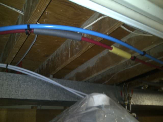

leeboy Posted March 7, 2012 Report Share Posted March 7, 2012 does anyone have any feed back on these? I dont see them much./Users/apple/Downloads/IMG-20120303-00435.jpg Click to Enlarge 35.44 KB Link to comment Share on other sites More sharing options...
Brandon Whitmore Posted March 7, 2012 Report Share Posted March 7, 2012 It's PEX, which is approved and seems to be good stuff overall. Link to comment Share on other sites More sharing options...
leeboy Posted March 7, 2012 Author Report Share Posted March 7, 2012 Funny I cant say I have ever seen 3/4'' line on a hot water supply line. red and blue are pex as well? not sure on that one. Link to comment Share on other sites More sharing options...
tbird Posted March 7, 2012 Report Share Posted March 7, 2012 Funny I cant say I have ever seen 3/4'' line on a hot water supply line. red and blue are pex as well? not sure on that one. Yup, PEX comes in many sizes and colors. Red for hot, blue for cold or white/opaque for generic. They even make yellow PEX (for gas). Link to comment Share on other sites More sharing options...
Robert Jones Posted March 7, 2012 Report Share Posted March 7, 2012 I have yet to run into an issue with PEX as far as the material goes. Can't say that about it's installation on a few occasion's. Just about all of the new construction in this area is run with PEX. Link to comment Share on other sites More sharing options...
leeboy Posted March 7, 2012 Author Report Share Posted March 7, 2012 Everything here is pex too, just havnt seen or had plumbers use red or blue yet. I have seen missed crimps sneak up and flood one of my jobs though Link to comment Share on other sites More sharing options...
Jim Katen Posted March 7, 2012 Report Share Posted March 7, 2012 Funny I cant say I have ever seen 3/4'' line on a hot water supply line. red and blue are pex as well? not sure on that one. It's common to upsize the PEX because of its narrower ID. Link to comment Share on other sites More sharing options...
John Kogel Posted March 7, 2012 Report Share Posted March 7, 2012 Red for hot, blue for cold or white/opaque for generic. They even make yellow PEX (for gas). Blue's for cold until they run out of the blue. Then they'll use red for both. Link to comment Share on other sites More sharing options...
Charlie R Posted March 7, 2012 Report Share Posted March 7, 2012 See it here occasionally , biggest issues I see are usually with the Zurn fittings, some of which were recalled, and if it got nicked by anyone during construction which creates a weak spot. Link to comment Share on other sites More sharing options...
ericwlewis Posted March 8, 2012 Report Share Posted March 8, 2012 I've used a lot of Pex over the last several years, red, blue, deep blue, rust and white. My plumber buddy told me to only use 3/4 as a main (for copper or Pex) until it branches to an individual fixture. And I learned myself NEVER to use 1/2" as a tub spout supply [:-dunce] It doesn't provide enough flow to keep the shower head from operating FULL TIME! Some manufacturers have changed that but I still go ahead and sweat the spout supply. Link to comment Share on other sites More sharing options...
