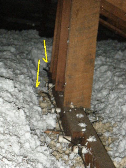

Denray Posted March 2, 2012 Report Share Posted March 2, 2012 We can make the house warmer. Click to Enlarge 60.8 KB Link to comment Share on other sites More sharing options...
John Dirks Jr Posted March 2, 2012 Report Share Posted March 2, 2012 Yes, the attic on fire will make the house warmer for sure! Link to comment Share on other sites More sharing options...
leeboy Posted March 2, 2012 Report Share Posted March 2, 2012 is the knob and tube still in use in that house? Link to comment Share on other sites More sharing options...
Denray Posted March 2, 2012 Author Report Share Posted March 2, 2012 Yep, or I wouldn't have bothered to take the photo. I like it when there is a new panel on the outside of the house then live K%T in the attic and crawl. Link to comment Share on other sites More sharing options...
leeboy Posted March 2, 2012 Report Share Posted March 2, 2012 Sounds like a deal killer, good find! Link to comment Share on other sites More sharing options...
