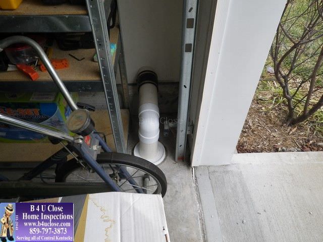

Les Posted February 27, 2012 Report Posted February 27, 2012 some examples. I love the plexiglass caulked to floor. Click to Enlarge 51.41 KB Click to Enlarge 50.89 KB Click to Enlarge 50.79 KB Click to Enlarge 59.45 KB Click to Enlarge 49.46 KB
