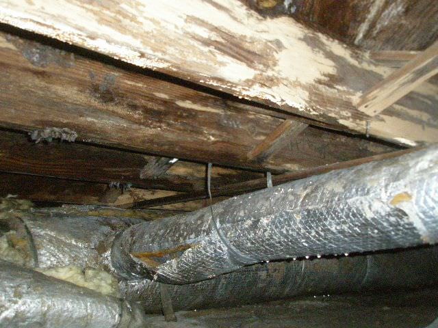

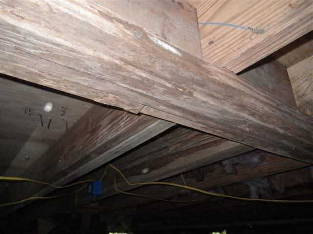

palmettoinspect Posted February 24, 2012 Report Share Posted February 24, 2012 It?s been my experience that almost every conventionally vented crawlspace I inspect here in Charleston has a moisture issues. The humidity plays a huge roll, ductwork doesn?t help nor does the floor insulation. I encourage dehumidification and sealed crawlspace and try to educate my clients about them when I run into such. Even attics near the beach that are conventionally ventilated have moisture issues related to humidity. I wanted to attach some pictures of actually homes I?ve inspected to show you how conventional type ventilated crawlspaces do not always work. These first pictures are from a house in Mt. Pleasant only 6 years old. TJI floor joists. Floors were insulated, but animals had torn most of it down. No ductwork. I inspected in back in October and the moisture readings in the wood were about 10-12%. I would imaging during the summer months they would be 30% +. Click to Enlarge 30.73 KB Click to Enlarge 31.91 KB This one was a home in Johns Island that did not have ductwork or insulation. The first picture is before I started probing the wood and the second shows how rotted the wood is and my probe easily breaking the wood apart. Click to Enlarge 40.36 KB Click to Enlarge 43.52 KB Here?s one in West Ashley in the Byrnes Down subdivision. The picture speaks for itself. Click to Enlarge 82.52 KB Link to comment Share on other sites More sharing options...

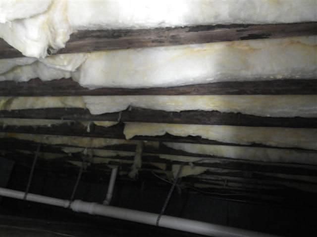

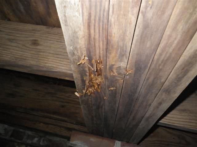

palmettoinspect Posted February 25, 2012 Report Share Posted February 25, 2012 And here's more from todays inspection. Also in the Byrnes Down subdivision. Click to Enlarge 42.34 KB Click to Enlarge 39.14 KB Link to comment Share on other sites More sharing options...

hausdok Posted February 25, 2012 Report Share Posted February 25, 2012 It?s been my experience that almost every conventionally vented crawlspace I inspect here in Charleston has a moisture issues. The humidity plays a huge roll, ductwork doesn?t help nor does the floor insulation. I encourage dehumidification and sealed crawlspace and try to educate my clients about them when I run into such. Even attics near the beach that are conventionally ventilated have moisture issues related to humidity. I wanted to attach some pictures of actually homes I?ve inspected to show you how conventional type ventilated crawlspaces do not always work. These first pictures are from a house in Mt. Pleasant only 6 years old. TJI floor joists. Floors were insulated, but animals had torn most of it down. No ductwork. I inspected in back in October and the moisture readings in the wood were about 10-12%. I would imaging during the summer months they would be 30% +. Click to Enlarge 30.73?KB Click to Enlarge 31.91?KB This one was a home in Johns Island that did not have ductwork or insulation. The first picture is before I started probing the wood and the second shows how rotted the wood is and my probe easily breaking the wood apart. Click to Enlarge 40.36?KB Click to Enlarge 43.52?KB Here?s one in West Ashley in the Byrnes Down subdivision. The picture speaks for itself. Click to Enlarge 82.52?KB What I've never understood is why, since they've known for a lot of years that humidity in crawls causes major issues in South Carolina's really humid climate, is why they don't routinely treat the underside of houses there with a fungicide before they finish them off. Hell, if the builder would have only gone under that house and saturated the hell out of everything with BoraCare before having the insulation installed, the underside of that house might have gotten damp but it would have stayed free of wood fungi. $500 - the cost of a couple of gallons of BoraCare and the labor involved with having a Snuffy go under there with a pump sprayer and nuke everything. $500 per hour - the cost of a lawyer for one of the hundreds of hours he'll be dinking around 'defending" the builder when a homeowner sues over rot like that. ONE TEAM - ONE FIGHT!!! Mike Link to comment Share on other sites More sharing options...

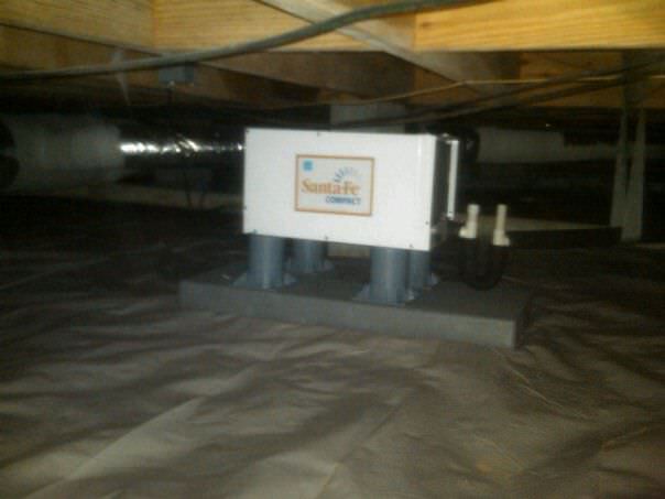

palmettoinspect Posted March 2, 2012 Report Share Posted March 2, 2012 Borecare is rarely used around here. Mainly just for a secondary prevention measure for termites. While it would help prevent growth it?s still not preventing the moisture issues due to high humidity in a confined space. The only thing I?ve seen that actually works is sealing off the crawlspace vents. Add a vapor/moisture barrier (depending on the amount of ground moisture) and installing a dehumidifier. The dehumidifier will maintain a humidity level that will not let the fungi grow. I?ve seen it work time after time. Here a picture of one that a buddy of mine installs. Click to Enlarge 34.82 KB Link to comment Share on other sites More sharing options...
Tom Raymond Posted March 2, 2012 Report Share Posted March 2, 2012 That's close quarters. I hope that unit is quiet. Link to comment Share on other sites More sharing options...
kurt Posted March 2, 2012 Report Share Posted March 2, 2012 My experience is that if you have a good vapor barrier on the floor I would argue to insulate the perimeter and condition the crawlspace. Absolutely. Preferably, closed cell foam sprayed from rim lapping down over the VB. I was even in one the other day that had the floor sprayed for the VB. It was like crawling around in a Willy Wonka cave. Link to comment Share on other sites More sharing options...
