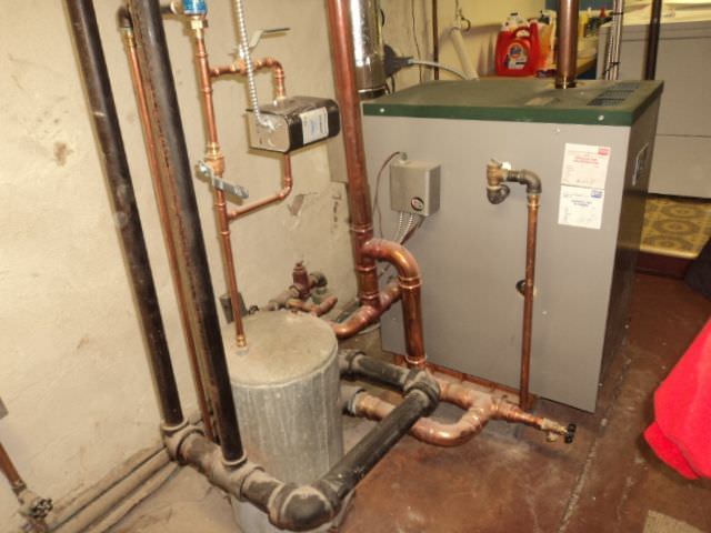

Neal Lewis Posted February 12, 2012 Report Share Posted February 12, 2012 This is a newer gas fired single pipe steam boiler. The water feed is connected to the tank, and the return is also connected to the tank. There is a circulator pump for a takeoff zone. The takeoff zone piping isn't connected to the tank. Any ideas what the tank is there for? Also, the Unimatch automatic feed valve is on it's side. The manufacturer specifically states the auto feed should be upright, yet I see this installation constantly. And this one was inspected by the building dept. Is there any adverse effect by installing it on it's side? Click to Enlarge 48.54 KB Link to comment Share on other sites More sharing options...
kurt Posted February 12, 2012 Report Share Posted February 12, 2012 Are those Shark Bite/quick connect fittings on all that copper? Link to comment Share on other sites More sharing options...
Neal Lewis Posted February 12, 2012 Author Report Share Posted February 12, 2012 Yes, like a ProPress fitting. First time I've seen them on a steam boiler. Link to comment Share on other sites More sharing options...
kurt Posted February 12, 2012 Report Share Posted February 12, 2012 Well, now I'm mystified by two things. The tank is curious, the copper and ProPress fittings strange for a steam system. Link to comment Share on other sites More sharing options...
Bill Kibbel Posted February 12, 2012 Report Share Posted February 12, 2012 For a "modern" steam boiler install, the most common reason for adding a collection tank on the condensate return is that the condensate is too slow in returning to the boiler. It's considered fixing a symptom but not the problem. I'm guessing this is a replacement boiler on an old piping system. Link to comment Share on other sites More sharing options...
Rob Amaral Posted February 18, 2012 Report Share Posted February 18, 2012 Let's see.. auto-fill valve and manual fill valves are 'closed' (unless unit is calling to fill the boiler).. -Galvi tank is filled in between 'fills' of low-water calls.to the top?. -Tank top (filled-state) is 'at or just below' (?) the boiler water level... -There's a hydronic zone off that boiler below the water level... (Doesn't matter) -Hartford return clearly in view... (normal) When boiler is in a 'low-water' state and calling on the auto-fill, there probably is an air-gap at the top of that galvi tank.. "boiler-fill water hammer arrestor"? (Those auto-fill valves can be noisy..) Odd.. Link to comment Share on other sites More sharing options...
