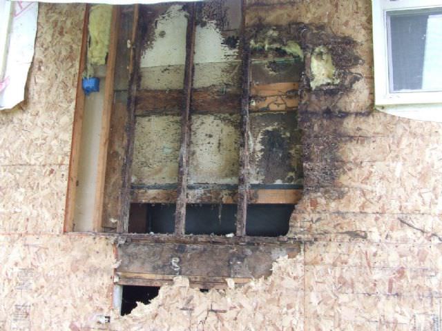

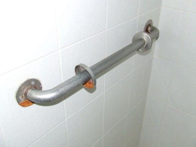

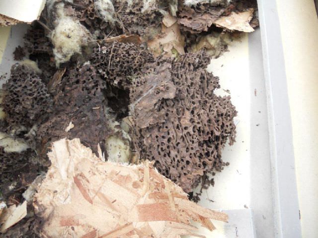

Denray Posted February 9, 2012 Report Share Posted February 9, 2012 I got these photos from my wife who is an independent claims adjuster. Owners had siding that was bulging so they removed it and here you go. There were two water sources discovered. One being the grab rails inside the shower. The other a leaking hose bib. One shot shows the little critters. Are they termites? They are smaller than what I have seen, but are otherwise ant like. Click to Enlarge 69.7 KB Click to Enlarge 24.86 KB Click to Enlarge 59.17 KB Click to Enlarge 66.72 KB Click to Enlarge 68.92 KB Link to comment Share on other sites More sharing options...
Jim Katen Posted February 9, 2012 Report Share Posted February 9, 2012 Moisture ants. Link to comment Share on other sites More sharing options...
Denray Posted February 9, 2012 Author Report Share Posted February 9, 2012 I thought you were joking till I googled it up. Thanks Jim Link to comment Share on other sites More sharing options...
Jim Katen Posted February 9, 2012 Report Share Posted February 9, 2012 I thought you were joking till I googled it up. Thanks Jim Sorry for my brevity. I figured that, in Eureka, moisture ants would be as common as fleas on a hippie. Link to comment Share on other sites More sharing options...

John Kogel Posted February 10, 2012 Report Share Posted February 10, 2012 That was a huge rot hole in that wall. It is amazing how insects can find these things. They must send scouts out all over the neighborhood, "Go find us a water leak". Link to comment Share on other sites More sharing options...
