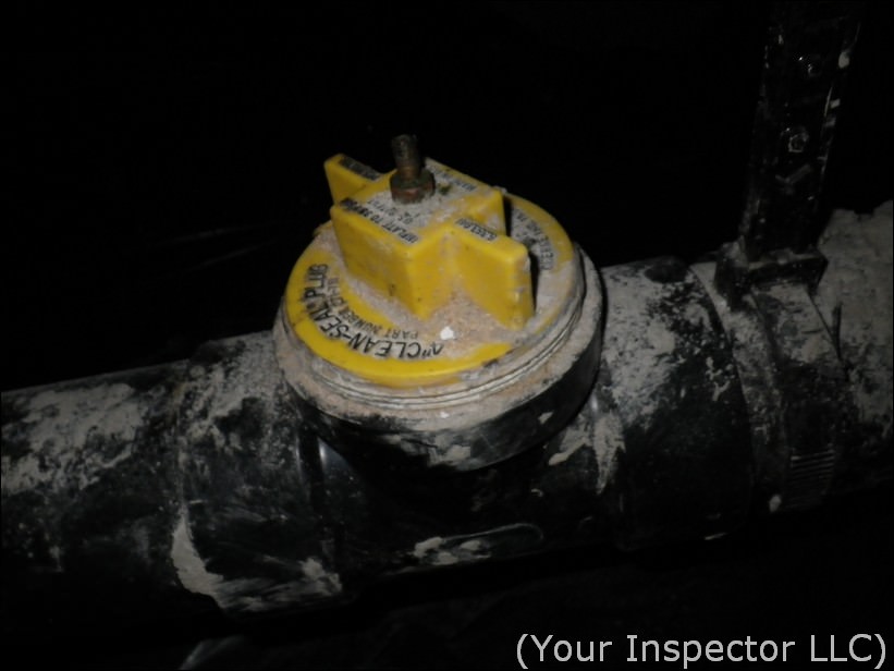

hausdok Posted January 31, 2012 Report Posted January 31, 2012 New house. Built in 2008 but never sold. Originally over $4M now listed for $1.8M. Found this in the main soil pipe. I've never seen one but I suspect it's used by plumbers to pressure-test systems for leaks. Don't know if it's inflated or not. Don't think it is. If it were, I should think at least one of the toilets would have backed up by now. My guess is that there is a plumber somewhere who went to his truck one day and went, "Oh sh*t, where the hell is the...." ONE TEAM - ONE FIGHT!!! Mike
Jim Katen Posted January 31, 2012 Report Posted January 31, 2012 Test plug left over from the time of construction. I've got half a dozen of them somewhere around here. Even deflated, I'm surprised that it hasn't caused serious problems with drainage in that system. It could be that the rubber bulb was damaged and someone sliced it off and used the remainder as a cap.
hausdok Posted January 31, 2012 Author Report Posted January 31, 2012 Test plug left over from the time of construction. I've got half a dozen of them somewhere around here. Even deflated, I'm surprised that it hasn't caused serious problems with drainage in that system. It could be that the rubber bulb was damaged and someone sliced it off and used the remainder as a cap. Maybe, but the cleanout cap was sitting on the vapor barrier nearby. Perhaps it hasn't caused an issue because nobody is living in the house yet. Thanks. OT - OF!!! M.
Jim Katen Posted January 31, 2012 Report Posted January 31, 2012 Test plug left over from the time of construction. I've got half a dozen of them somewhere around here. Even deflated, I'm surprised that it hasn't caused serious problems with drainage in that system. It could be that the rubber bulb was damaged and someone sliced it off and used the remainder as a cap. Maybe, but the cleanout cap was sitting on the vapor barrier nearby. Perhaps it hasn't caused an issue because nobody is living in the house yet. I'd have just unscrewed it for a looksee inside. . .
