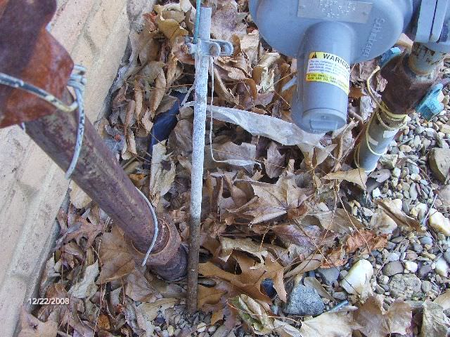

AHI in AR Posted January 22, 2012 Author Report Share Posted January 22, 2012 Thanks for the replies. It may be a regional thing, but I might see one hollow rod for every fifty solid ones. Generally, the hollow ones are on older installations. I always wiggle solid rods to try to gauge whether they are possibly too short, but I don't grab or wiggle the older, hollow ones precisely because I am afraid they might break. On a related note, this pic is of a rod I easily pulled out that was inserted all of 6" deep...and most of that was through gravel. As you can see the total rod length was less than 2'. The home was built in 2002 in a town that does have muni inspections. It appears that the inspector was sleepwalking that day. Click to Enlarge 105.71 KB Link to comment Share on other sites More sharing options...
