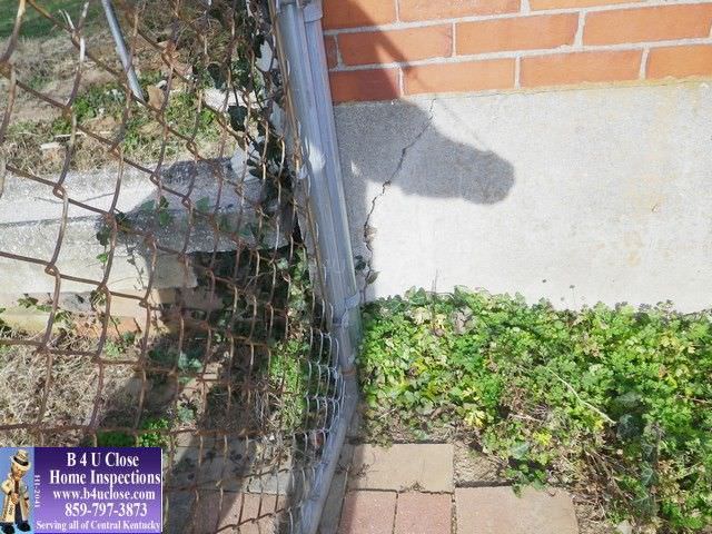

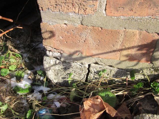

Erby Posted January 18, 2012 Report Share Posted January 18, 2012 Anybody have a good authoritative reference for this. Click to Enlarge 95.06?KB Click to Enlarge 88.81?KB Appraiser noted it requesting a structural engineer review. Bank is going along with it. I'm looking for a good authoritative reference (cause and effect) that the bank might accept in lieu of a $400 structural engineer. - Link to comment Share on other sites More sharing options...

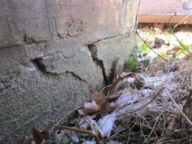

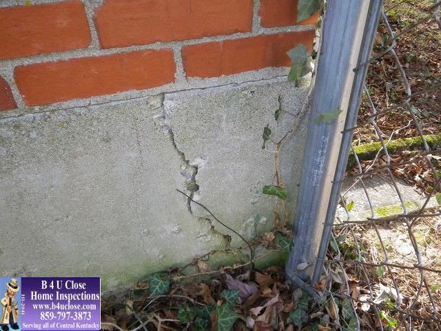

Mike Lamb Posted January 18, 2012 Report Share Posted January 18, 2012 Anybody have a good authoritative reference for this. Click to Enlarge 95.06?KB Click to Enlarge 88.81?KB Appraiser noted it requesting a structural engineer review. Bank is going along with it. I'm looking for a good authoritative reference (cause and effect) that the bank might accept in lieu of a $400 structural engineer. - No reference other than my own experience. I've seen hundreds, maybe thousands, with no structural or seepage concerns. I've called it a "corner shear". A name I made up. It's not peculiar to brick veneer as the stated in the article Tom linked but just as harmless. I walked outside and took a pic of the corner of my own house which is solid masonry wall construction. Click to Enlarge 84.12?KB Click to Enlarge 74.12?KB Link to comment Share on other sites More sharing options...
Nolan Kienitz Posted January 18, 2012 Report Share Posted January 18, 2012 Tom Witherspoon has his Phd and is a PE in the D/FW market and has written about "corner pops" or "wedge cracks". He is well respected and an involved engineer. Here is the URL to his website: Tom Witherspoon Below is what I put in my reports about the "corner pops" or "wedge cracks": Comment: Corner(s) of foundation were observed to be cracked. W. Tom Witherspoon, PE; has commented in his book: Residential Foundation Performance about cracked foundation corners: "Cracking at the corners is a very common feature in concrete foundations. It is very common to see spalling concrete, commonly called "wedge cracking" at the corners with no damage to the brick. This anomaly is normally caused by a thermal expansion coefficient difference between brick and concrete which terminates at the corners. Seldom is there a foundation problem, but it is very unsightly and must be repaired in severe cases." Link to comment Share on other sites More sharing options...
Garet Posted January 19, 2012 Report Share Posted January 19, 2012 My understanding... Brick is the driest (and smallest) the day it leaves the kiln. It expands slightly as it gains moisture. Concrete shrinks slightly as it cures, and it never completely stops curing. Thus, the brick wall gains length as the foundation gets shorter. Different rates of thermal expansion/contraction also play into it. Eventually, the immovable object meets the irresistible force. Then, cracks happen. Clients sometimes ask about it. Even if not, I talk about it to make sure they know I saw it and that it's not a big deal. It does not make it into the report. I'd go outside and take a picture of the cracks on my own house, but it's dark, I'm lazy and they wouldn't look any different than the one you posted. Sorry, but I can't help you with an authoritative source to save the $400. Appraisers should stick to appraising. Link to comment Share on other sites More sharing options...
