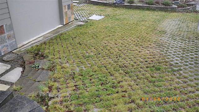

Robert Jones Posted January 7, 2012 Report Posted January 7, 2012 This is a newly constructed home. Hopefully the pic does it justice but those are individual concrete blocks/pavers. The grass has taken over. Is "pavers" the right term for these? Entire driveway was covered with these. Click to Enlarge 75.12 KB

kurt Posted January 8, 2012 Report Posted January 8, 2012 Permeable pavers here. They're all over China. We're going to be seeing more and more of them; they're a smart alternative to hardscaping everything and having to engineer drainage.

mgbinspect Posted January 8, 2012 Report Posted January 8, 2012 Believe it or not, they've been around for quite some time. I installed them for the first time at a Magnavox plant outside of Wahington DC., in the mid-eighties. Their original intent was to be a nice way to have over-flow parking, without suffering devastation of a lawn during the intermittent times that it became a parking lot. They are perfectly flat and as smooth as any concrete masonry unit, so they actually can be shoveled or plowed, without too much consequence. The voids, that turf grow up through are only a few inches, so it's pretty hard to catch an edge, as long as the shovel or plow blade is pretty flat and wide.

mgbinspect Posted January 9, 2012 Report Posted January 9, 2012 The whole process was new to me, but very well thought out. The base was gravel covered by a layer of crusher run, which was all compacted with a plate tamper. Then, the pavers were laid into place - no worries regarding getting them to the perfect height because the entire installed system received three passes with a plate tamper. A few pieces would break during that process needing to be replaced. Finally, they came behind us and filled in the voides, to within about an inch of the top with soil and seed, and presto! It was the first part of a three phased project, and the pavers never settled or bbubuckled. It was pretty cool.
