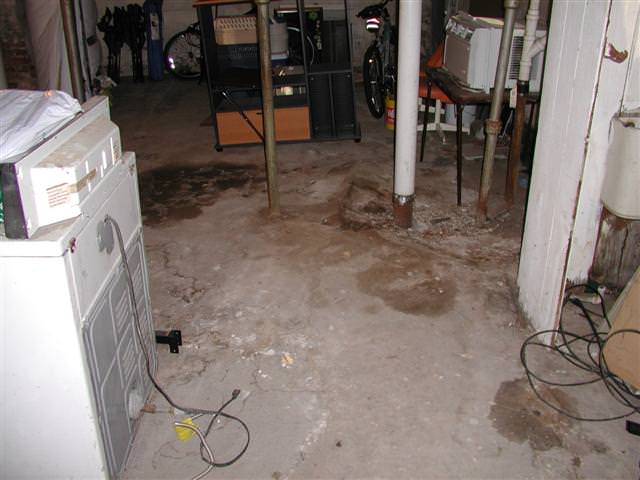

Terence McCann Posted May 7, 2005 Report Posted May 7, 2005 Hello All: On a few of the older homes that I have inspected the basement floor (concrete) has pushed up. When you knock on it it's as hollow as a drum. I would guesstimate that this is due to freeze/frost conditions pushing the floor up however, I would have thought the floor was below the frost line. Also, wouldn't you need an active source of water to lift the floor. Some areas are pushed up a foot or more. Comments? Thanks... Download Attachment: basement1.jpg 39.47 KB Download Attachment: basement2.jpg 46.88 KB
Bill Kibbel Posted May 7, 2005 Report Posted May 7, 2005 I see this condition almost daily. Typically, a very thin layer of concrete was added later only as a soil covering. No gravel, vapor barrier or reinforcing mesh is present. As the concrete cracks and settles over soft soil, the other edge lifts. There is sometimes soil erosion from water movement and heaving as water rises under the concrete. It can also be a result of failed waste lines washing out soil under the slab. Looking at the second photo, showing pretty ancient cast waste lines penetrating the floor, I would suspect this may be a probable cause.
Terence McCann Posted May 7, 2005 Author Report Posted May 7, 2005 Hi Bill & thanks for the reply. If the waste line were leaking wouldn't his cause a sink hole effect due to soil errosion? This is just like someone put a balloon under the floor, a big bubble.
kurt Posted May 7, 2005 Report Posted May 7, 2005 I see it daily also. City infrastructure backups can cause the old clay tiles to leak & flood the subgrade soil under the concrete. Bill described old concrete floors perfectly; it is usually just a skim of weird flinty mud over the dirt. When you flood the area, it bubbles up. Old city sewers back up, clay tile bell & hub joints leak, & floors buckle. I always tell folks to videoscope the sewer to determine it's condition.
Bruce Thomas Posted May 13, 2005 Report Posted May 13, 2005 Terence, There is another possibility. High water table intermittently. The water pressure cracks to concrete (stains), then goes back down and compacts the soil underneath causing the hollow sound. This is one of the rare cases where I recommend interior drains and a sump pump. The entire floor may need to be removed and replaced but after the drainage is added. Bruce
