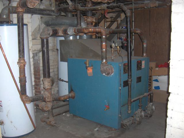

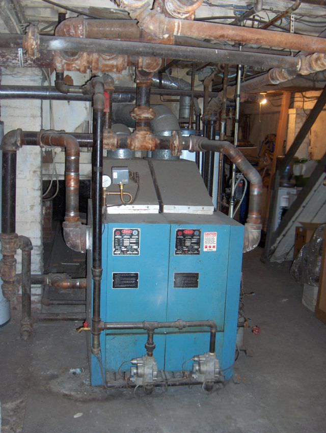

allseason Posted December 8, 2011 Report Posted December 8, 2011 I was in a circa 1890 boarding house recently. Central heat with steam boiler(s), Utica circa 1978. I have not seen a set up like this before, it looks like two boilers with individual burners attached to each other as you would sections of a radiator. When tested only one side fired up. Is the other side to provide addtional heat should the one burner be inadequate or should both run together. There is only one thermostat, TPRV, low water cut off , etc. New to me, anyone familiar with this arrangment? Click to Enlarge 96.2 KB Click to Enlarge 46.66 KB
Bill Kibbel Posted December 8, 2011 Report Posted December 8, 2011 That set-up is common for replacements of big old boilers (easier to get two sections down the narrow basement stairs). For steam, both sides should be firing.
kurt Posted December 8, 2011 Report Posted December 8, 2011 What Kibble said. I see this occasionally, although I've never seen one where only one unit fires. If there's a single T-stat, it should fire both boilers, no?
Chad Fabry Posted December 9, 2011 Report Posted December 9, 2011 Quote If there's a single T-stat, it should fire both boilers, no? Like Bill said- for steam both units should fire. For hydronic, they could be set-up with a pair of aquastats so the second one fires only when the primary cannot keep up with demand ...or they could be setup with one aquastat so that they both fired on demand.
kurt Posted December 9, 2011 Report Posted December 9, 2011 Yeah, OK. I've just seen them with a single aqua stat, single t-stat, boilers run in parallel.
Jim Morrison Posted December 9, 2011 Report Posted December 9, 2011 Also, copper risers? That is an unfailing sign of an installer who doesn't understand steam systems.
