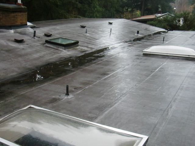

randynavarro Posted December 8, 2011 Report Posted December 8, 2011 How does one solve the inadequate draining on this roof? Click to Enlarge 45.61 KB
Erby Posted December 8, 2011 Report Posted December 8, 2011 Install drains (and drain piping in the attic) at the low spots would likely be most economical.
kurt Posted December 8, 2011 Report Posted December 8, 2011 OK........ducts in the "attic", inadequate venting, non-draining roof. How about recessed lights in the top floor ceiling? There's a bunch of stuff going on here; now I really don't know what to tell you. Beware improvised ventilation schemes with mechanical solutions; there's something about this I really don't like. Pics are the order of the day: I'm curious what we're really talking about.
