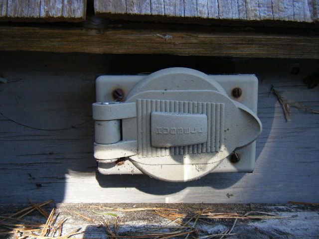

Denray Posted December 2, 2011 Report Posted December 2, 2011 Is this some kind of exterior electrical outlet with some kind of plug in it to protect it? Click to Enlarge 65.84 KB Click to Enlarge 61.73 KB
Brandon Whitmore Posted December 2, 2011 Report Posted December 2, 2011 That's what it looks like-- did you test it? Something about the fit of the receptacle to the cover doesn't look right though.....
Jim Katen Posted December 2, 2011 Report Posted December 2, 2011 I think it's just a twist lock receptacle with an improperly sized coverplate.
John Kogel Posted December 2, 2011 Report Posted December 2, 2011 For an RV, maybe? The cover didn't fit very well in that narrow space, so he turned it sideways.
Denray Posted December 2, 2011 Author Report Posted December 2, 2011 Thanks everyone. I wasn't sure what it was, but just looked up Hubbell twist lock receptacles and there it all was. I didn't twist its innerds, and should have.[:-paperba
tim5055 Posted December 3, 2011 Report Posted December 3, 2011 Generator hookup or RV hookup. Not RV, the only 110v RV receptacle is a NEMA TT-30R

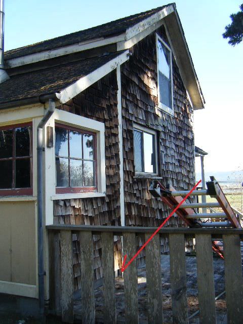

Denray Posted December 3, 2011 Author Report Posted December 3, 2011 It's at a little old isolated cabin at the top of their front deck, so probably a generator set up? Click to Enlarge 67.95 KB
Jim Katen Posted December 3, 2011 Report Posted December 3, 2011 You can plug whatever 120-volt appliance you want in there as long as you use the corresponding plug.
