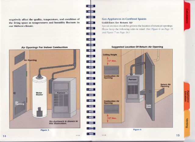

Mike Lamb Posted December 1, 2011 Report Posted December 1, 2011 I recall if you get the air from outside you need 25% of the indoor requirements? But that's more typical for multi-units with a common boiler. Kurt was talking about this I assume: Click to Enlarge 46.17?KB

kurt Posted December 1, 2011 Report Posted December 1, 2011 Mike Lamb said: I recall if you get the air from outside you need 25% of the indoor requirements? But that's more typical for multi-units with a common boiler. Kurt was talking about this I assume: Click to Enlarge 46.17?KB Yup. Dryer closets also need makeup air, not just combustion air. Any calcs should include makeup air. Yeah, no incredulity here either. We all have businesses because no one reads instructions.

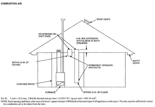

John Kogel Posted December 2, 2011 Report Posted December 2, 2011 Nice catch, Mike. I imagine the homeowner was mystified as to what those things were on the wall outside. What about pulling combustion air down from the attic through a 4 or 5 " pipe? If soffit vents are plentiful, are there any negative issues with that?
Mike Lamb Posted December 2, 2011 Report Posted December 2, 2011 John Kogel said: What about pulling combustion air down from the attic through a 4 or 5 " pipe? If soffit vents are plentiful, are there any negative issues with that? No. The IRC shows different ways this can be done. M1703.3 Attic combustion air. I usually see a 2 pipe configuration around here but I guess one pipe is OK, too. Click to Enlarge 28.5 KB
