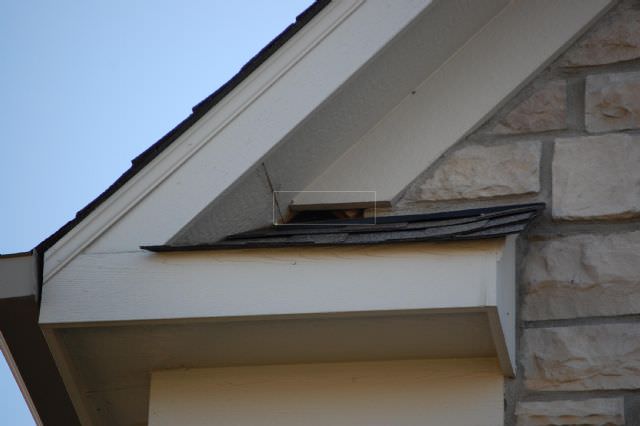

My front window is leaking from the top when the rain is heavy and drifting with the wind. The leak does not happen if it is not windy and the rain is low. There is no visible gap or whole around window. It is a stonefront all around the window as shown in the picture. I sealed around the window OSI caulk and still the water is leaking from inside top during the recent rain.
This makes me think of rain water must be entering from the roof. I have attached a picture where there is an inch gap with no flashing at all.
Do you think this is the source of water entering? What is the best way to fix this gap? Any information will be much appreciated.

You're not gonna have a window right at the corner of the house, which leads me to believe the window is on that wall to the right. If that's the case, I would bet that the flashing/ weather resistive barrier was never properly installed behind the cultured stone (all a guess without pictures, and even then...) Caulk shouldn't be needed to prevent water leakage at a window. If you've got a leak, you've got other issues besides the lack of surface sealant.
Posted
They put the masonry veneer on without any head flashings or drainage screeds and when it rains hard the water builds up behind the veneer and forces it's way through the wall. If you applied a lot of goop along the bottom of the veneer you've only made it worse.
Go here and study the application/installation details and compare them to what you've got and you'll soon understand why.

As Mike noted, it is most likely a flashing issue. Most likely the fins on the window were not taped/flashed to the Tyvek or whatever type of WRB they used on the substrate.
How old is the house?
Did this just start?

How old is the house? - 5 yrs old
Did this just start? - yes, about a month back.

Thanks for the pictures. The leaks have nothing to do with the missing flashing at the roof.
The water is entering behind the stone just below the upper window. To fix this particular leak properly, the stone between the two windows has to come off and be reinstalled properly with correct flashings & paper. Anything less won't work.
The fact that this is leaking is probably an indication that the entire stone veneer installation is done improperly. It is almost certainly leaking in other locations as well, though the leaks might not be in places that you can see.
