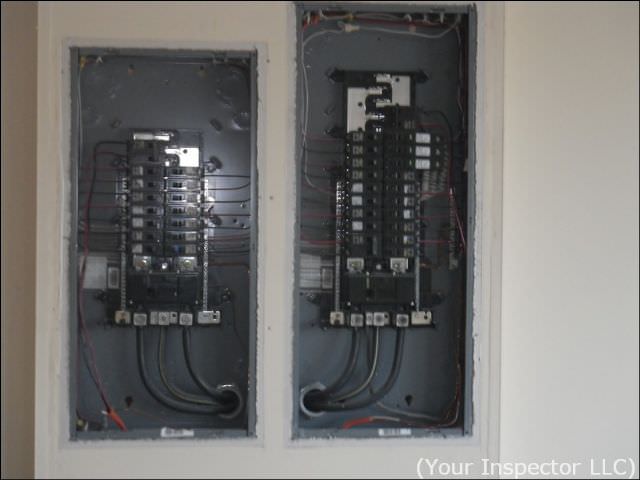

hausdok Posted October 6, 2011 Report Posted October 6, 2011 Had this one recently. I don't normally photograph these unless there is something wrong; but this one was very clean and very neat. That's two 200 amp load centers side by side. Click to Enlarge 37.11 KB

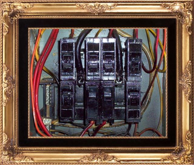

Jim Katen Posted October 7, 2011 Report Posted October 7, 2011 I think this is more along the lines of what Chad is thinking. Download Attachment: Chads New Service Panel.jpg 65.53 KB

Les Posted October 7, 2011 Report Posted October 7, 2011 I think this is more along the lines of what Chad is thinking. Download Attachment: Chads New Service Panel.jpg 65.53 KB That is one of my favorite photos of home inspection. With the right frame and mat it could hang in a gallery!
Chad Fabry Posted October 7, 2011 Author Report Posted October 7, 2011 I think this is more along the lines of what Chad is thinking. Download Attachment: Chads New Service Panel.jpg 65.53 KB It sure is pretty.
Jim Katen Posted October 7, 2011 Report Posted October 7, 2011 I think this is more along the lines of what Chad is thinking. Download Attachment: Chads New Service Panel.jpg 65.53 KB That is one of my favorite photos of home inspection. With the right frame and mat it could hang in a gallery! Well, then I should disclose that it's not mine, though I can't remember who I stole it from. Douglas might recall.
