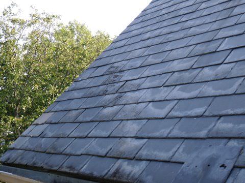

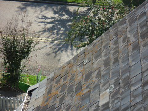

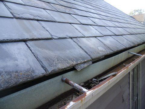

Plenty of negative to say about this roof but I have a few questions:
1. What is the growth on the slate and what are the effects?

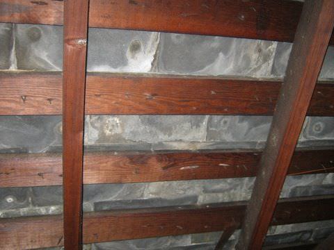

2. Why is the underside powdery? Other than the obvious "It is deteriorating".
3. I do not know the age but does this look like a lesser grade of material? I believe the classifications would be S2or S3 in that case.
4. Any other comments?
It's mostly a type of lichen. It would have more of an effect on more common types of roofing materials - very little on slate.
It is a soft-vain slate quarried mostly from Bangor and Pen Argyl in Northampton County, PA. It is quite porous as compared to slate quarried in most other areas (all slate is porous). The U-shaped discoloration on the surface and the powdering underneath is from many decades of moisture absorption and to a lesser degree, leaching of gypsum to the surface.
Please remove that "classification" system from your vocabulary. That is a grading system invented by folks that made it up to sell an ASTM standard. It's completely inappropriate to use to determine the age or remaining life of a slate roof.
What's the age of the house, the slope of the roof, the headlap, the type of nails and percentage of slates needing immediate replacement?
Posted
Well, so much for the reporter and my other references.
about 111 yrs
varies 8/12 and up
I do not know what the nail type is. Small diameter and rusting
I saw damage and poor repairs in 10%
Thank you for the help and education
Posted
Small and rusting means iron fasteners. I'm surprised they've lasted this long.
That's a roof that's going to start sloughing slates like snake skin in a few more years.
