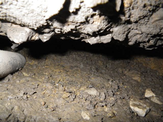

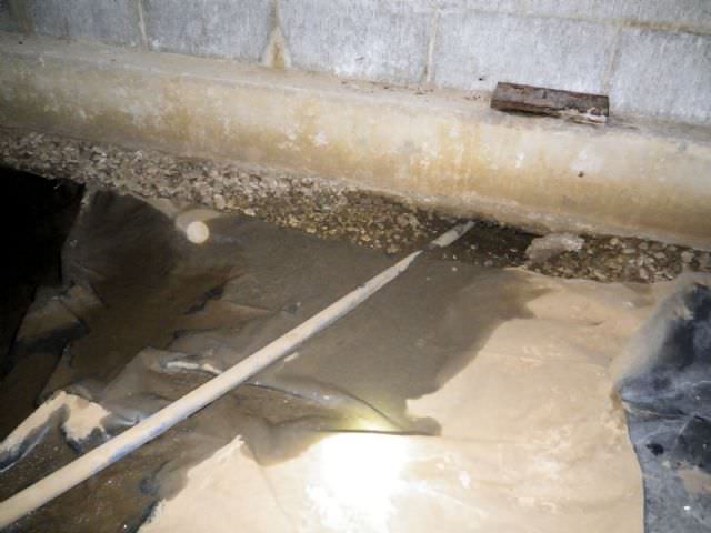

Mark P Posted September 12, 2011 Report Posted September 12, 2011 In this house, on crawl, built in 2003 the main water line from the street runs under the footing. I can't say I remember seeing this before; I typically see it running through the foundation wall ââ¬â but I may be having a senior moment. Erosion is occurring under the footing from water running through this opening. Even though it has not rained here for months, there is still a puddle of water. My concern is that if the erosion continues - after a bunch of years the footing will be compromised. My questions: Is running the water line under the footing allowed? Is it even addressed in code? What would you say about this? Do you share my concern about the erosion and eventually compromising the footing? Click to Enlarge 44.55 KB Click to Enlarge 64.94 KB
Garet Posted September 12, 2011 Report Posted September 12, 2011 I would not be at all concerned about lack of support under a short section of footing like that. Could be erosion, but I suspect it's been that way since the builder left unless there's a torrent of water flowing. I would be concerned about that much water if it "hasn't rained for months". Sounds to me like the water pipe has problems. FWIW, our neighbor's water pipe recently sprang a leak somewhere outside the foundation, with a similar amount of water inside the basement (as well as a flooded meter pit). Some flaw in the copper pipe sat there for 4 decades and finally let go.
Bain Posted September 12, 2011 Report Posted September 12, 2011 I see this sometimes, and it never seems to cause a problem. Did you check the water meter to make certain the pipe isn't leaking, Mark? I always look at the delta on the meter to make certain it's stationary, and find maybe one faulty water-main a year.
Erby Posted September 12, 2011 Report Posted September 12, 2011 Found two so far this year using the leak detector on the meter. Big dollar repair. I don't think I'd be too concerned about the lack of support over that short of distance. Instead I'd be looking for where the water was coming from.
Bain Posted September 12, 2011 Report Posted September 12, 2011 Found two so far this year using the leak detector on the meter. Big dollar repair. I don't think I'd be too concerned about the lack of support over that short of distance. Instead I'd be looking for where the water was coming from. Important Note: Utilizing the above technique with success will without fail make certain real estate agents HATE your f**king guts pretty much forever.
Mark P Posted September 13, 2011 Author Report Posted September 13, 2011 No I did not check the meter. I will return to the house and do so. Lesson Learned! Thanks for the comments. Have a great week inspecting.
Jim Katen Posted September 13, 2011 Report Posted September 13, 2011 Interesting difference in regional techniques. I can't remember ever seeing a water line enter a crawlspace through a hole in the stemwall. They all enter under the footing, just as in your photo.
John Dirks Jr Posted September 13, 2011 Report Posted September 13, 2011 I thought I remember something about required protection for lines running under footings. Maybe that was for waste lines. Anybody got anything on that?
Bill Kibbel Posted September 13, 2011 Report Posted September 13, 2011 I thought I remember something about required protection for lines running under footings. Maybe that was for waste lines. Anybody got anything on that? A "relieving arch" is required over supply or waste pipes under a footing.
Jim Katen Posted September 13, 2011 Report Posted September 13, 2011 I thought I remember something about required protection for lines running under footings. Maybe that was for waste lines. Anybody got anything on that? A "relieving arch" is required over supply or waste pipes under a footing. Or a sleeve two sizes larger than the pipe . . .

David Meiland Posted September 13, 2011 Report Posted September 13, 2011 We almost always run the water line under the footing, and we put pipe insulation on it. One thing that happens... if you cut a ditch down a hill to the foundation of a house, you often create a channel for water to follow, if the backfilled ditch is not as compact as the soil around it. I'm watching some guys build near me right now, and they dug a 2' deep ditch down a long slope right to the middle of their building footprint. If they're smart and they compact the soil well as they backfill, they'll probably be OK. If they let the excavator flip a bunch of fluffy soil back into the ditch, and blade the rest of it out in the general vicinity, they'll have a new creek running into the crawl space.
Jim Katen Posted September 13, 2011 Report Posted September 13, 2011 We almost always run the water line under the footing, and we put pipe insulation on it. One thing that happens... if you cut a ditch down a hill to the foundation of a house, you often create a channel for water to follow, if the backfilled ditch is not as compact as the soil around it. I'm watching some guys build near me right now, and they dug a 2' deep ditch down a long slope right to the middle of their building footprint. If they're smart and they compact the soil well as they backfill, they'll probably be OK. If they let the excavator flip a bunch of fluffy soil back into the ditch, and blade the rest of it out in the general vicinity, they'll have a new creek running into the crawl space. I've got to disagree. When they do that it *always* creates an underground stream. Unless they use a jumping jack in that trench in 12" lifts it will catch & channel water into the crawlspace. Nobody compacts trenches like that in residential construction.

Jim Baird Posted September 13, 2011 Report Posted September 13, 2011 not going to cite code, but supply should be sleeved and needs depth to protect from freezing. The one in the picture looks way to high up and must be leaking. We had a house in our area where the landscaper nicked a supply line while planting a tree, and as the water heater was the first stop on the way in, the little dirt getting in piled up in the tank and ruined the heater.
Tom Raymond Posted September 13, 2011 Report Posted September 13, 2011 Jim, it's under the footing. If it isn't at sufficient depth to protect it from freezing, he's got way bigger fish to fry.
