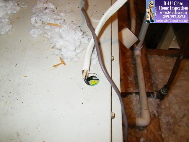

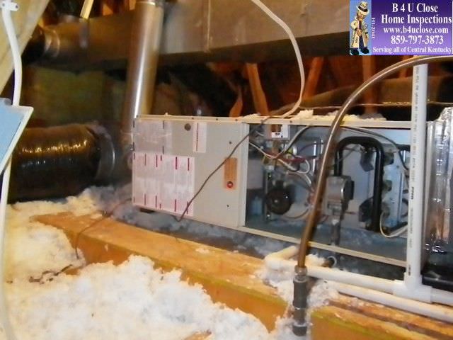

Erby Posted August 25, 2011 Report Posted August 25, 2011 Dang, you mean running cable like this is NOT OK. Click to Enlarge 56.16 KB Click to Enlarge 43.19 KB Where's that sarcasm emoticon when you need it!
Bain Posted August 25, 2011 Report Posted August 25, 2011 Dang, you mean running cable like this is NOT OK. Click to Enlarge 56.16 KB Click to Enlarge 43.19 KB Where's that sarcasm emoticon when you need it! I've busted the company whose sticker is on the furnace cabinet twice in the past month for egregious errors they made. A city inspector had blessed one of the installations and, to his credit, apologized when he was made aware of the flubs. The realtor for both transactions, whom you know, told the HVAC company supervisor, "At least you're an equal opportunity business. You screwed the rich white people in the $500,000.00 house just as readily as you screwed the poor black man in the $50.000.00 house." ahahahahahaha . . . .
Erby Posted August 25, 2011 Report Posted August 25, 2011 And this one was already 17 years old so you know they've been doing it "equal opportunity" for a long long time.
