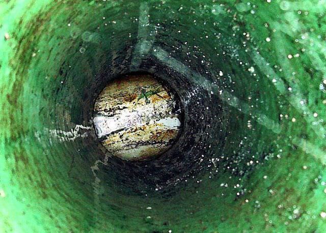

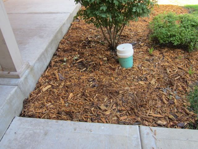

Mike Lamb Posted August 10, 2011 Report Posted August 10, 2011 This is why it's a good idea to look down clean-outs if possible. This sewer had about 2" of standing water in it. I dropped a wad of toilet paper down and it didn't move. Click to Enlarge 26.96 KB Click to Enlarge 84.1 KB This lid was easy to remove. Sometimes I use a large Channellock to unscrew the plug.

Brandon Whitmore Posted August 10, 2011 Report Posted August 10, 2011 I dropped a wad of toilet paper down and it didn't move. That's because you didn't flush.... I make it a habit of pushing on, and looking down all vent pipes/ stacks on the roof line as well. I've found many loose/ detached joints, and one a few weeks ago where the stack was never connected. Looking down the 3" pipe, all I could see was wall framing, distribution pipes, etc. I told them to put an elbow on the top so that the house could still vent while preventing rain water entry.

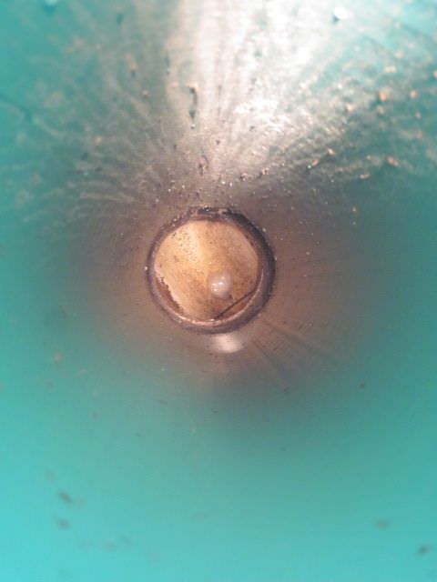

Mike Lamb Posted August 11, 2011 Author Report Posted August 11, 2011 Mike, Did't you take some shots looking into pipes a while back? Click to Enlarge 89.01 KB
