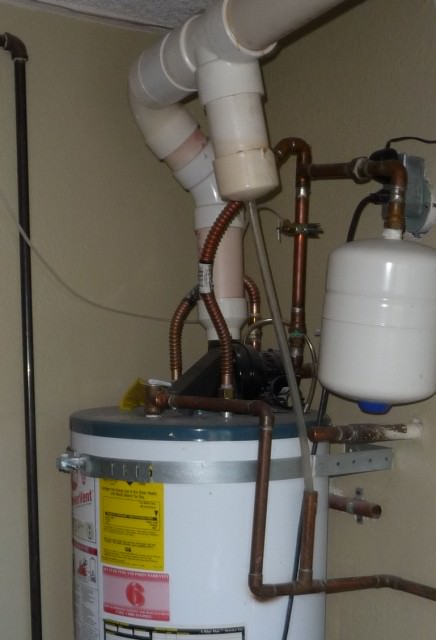

What a convoluted(spell check)bunch of junk!
Even if were actually functional anytime you have more than one 90 degree offset in the 3/4" line coming from pop off valve you need to increase the pipe to 1".
And the pop off is always independent to the end of line,I guess they werent too concerned about a bird or other rodent making a nest outside in the pvc pipe plugging it up and dumping carbon monoxide back down through his little drain hose! [:-censore
I nailed one of those bob villa types years ago venting a basement bath fart fan into a working brick chimney for a water heater,plumbing inspector had a good time with that idiot! [:-censore
