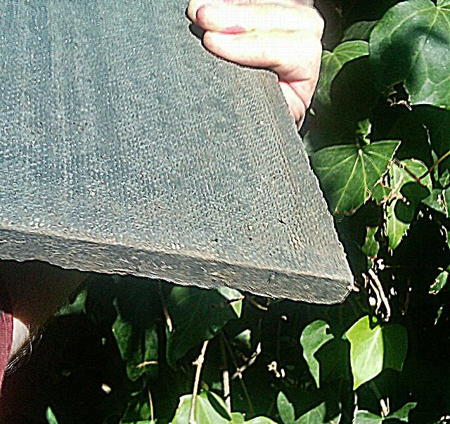

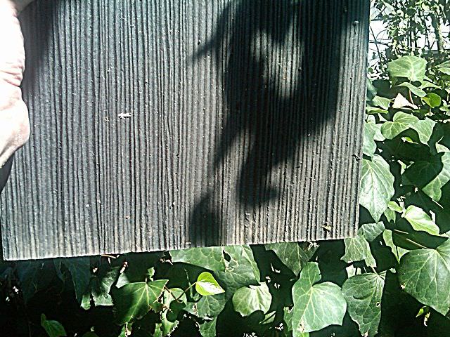

When I saw the roof from my truck, I muttered, "Cemwood"!
Not so. Fortunately, I found a pile of the shingles on the side of the house. The only branding is on the back of the shingle. "FF with a combination of plus and minus. "Made in Canada" is clear.
These shingles are clearly hardboard. A number of shingles on the roof were cracked. (like cemwood) Color variation from north to south exposures is not consistent.
Any guesses?
Any guesses?
They look like fiber cement, not hardboard.
