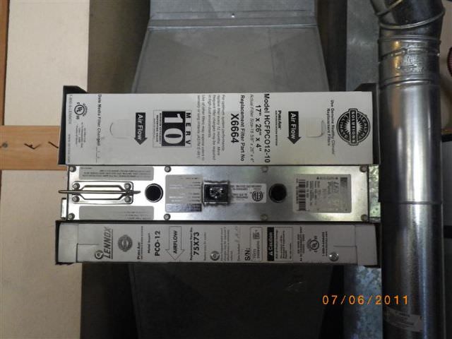

Robert Jones Posted July 8, 2011 Report Posted July 8, 2011 Anyone have any experience with this type of Lennox filter system? My pic of the model # had to much glare for me to "Google" it. Seems to be a type of electronic type system. I usually see the metal cell(s). Click to Enlarge 44.3 KB
Bill Kibbel Posted July 8, 2011 Report Posted July 8, 2011 That's the Lennox air purification system. Air passes through the pleated filter, then 2 UV lamps and then some kinda coated screen. Filter, lamps and screen get replaced annually.
