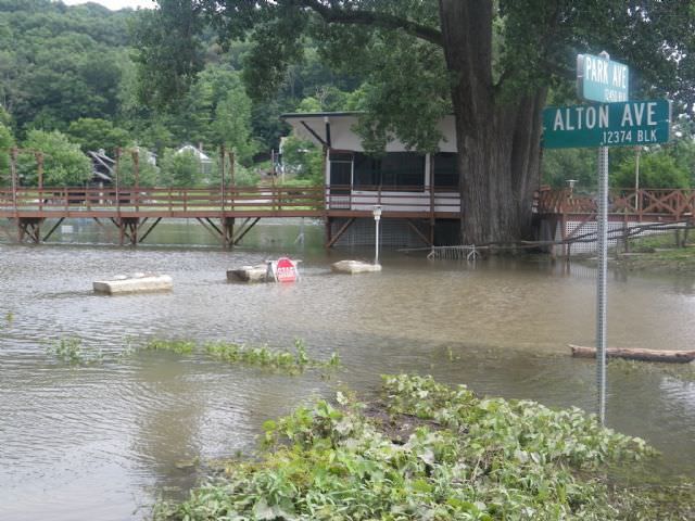

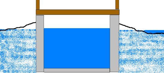

Mark P Posted June 26, 2011 Report Share Posted June 26, 2011 This past week I was in Grafton, IL that is right along the Mississippi river and floods a lot. The state and federal govââ¬â¢t is pretty serious about managing every pebble that can impact the height of the river. So many of the houses are built up and have flow through for the rising river under the house. State flood engineers tell the owners exactly how high a house has to be. Click to Enlarge 59.22 KB Click to Enlarge 74.9 KB Link to comment Share on other sites More sharing options...
