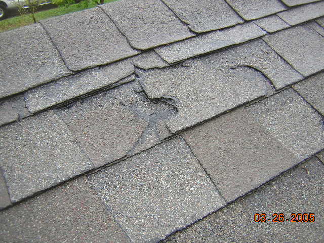

rlskfoster Posted April 23, 2005 Report Share Posted April 23, 2005 I definately climb all roofs if at all possible. I would have missed both of these if i hadn't gone ahead and made the climb. The first is a large occupied custom home built in 2003. The roof was leaking and had stained the ceiling in a garage, but, there was shelving that was partially hiding the stains. I found the damage and then went looking for where it might have leaked. I not certain I would have seen the stains. The shelves were loaded with stuff and hid the stains quite well. The second the picture was an older house with a second story. I was able to get up on top and found all kinds of damage on there. This is a back side that was not visible from the ground. The rest of the roof was in good condition and because of that I almost got off the roof without making the effort to get "up and over". The picture shows one spot but there numerous areas in similar shape. Large trees did this damage and they had been trimmed way back off the roof. I could not find any stains or evidence of leaks in this one. I will always try to climb the roof. Buster Download Attachment: Longoria 009.jpg 69.01 KB Download Attachment: Pointer2 047.jpg 106.7 KB Link to comment Share on other sites More sharing options...
