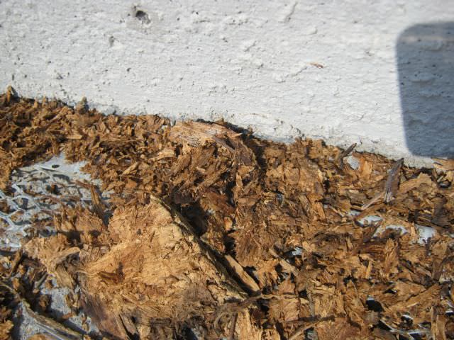

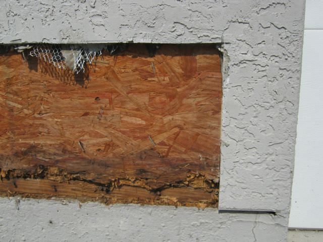

Rocon Posted June 1, 2011 Report Posted June 1, 2011 You will see other issues that contributed to the condition but this is some OSB I found last month. Click to Enlarge 62.59 KB and here is what it looked like on the ground after I removed it with my bare hand. Click to Enlarge 89.38 KB

Rocon Posted June 2, 2011 Report Posted June 2, 2011 Like any engineered material, it has to be used in a design specific manner. Which, of course, rarely happens. How often do folks see Exposure 1 material being used? How often do you see Exposure 2 for sheathing? Honestly, I hardly ever see the stuff. I've built with it, but I don't see it all that often on other than for reroofing over skip sheathing. My photos are of exposure 1 rated OSB installed in 2004. It seems that once the water is introduced to the OSB the lignan breaks down very quickly. The adhesives seem to have very little resistance to moisture.

kurt Posted June 2, 2011 Report Posted June 2, 2011 My photos are of exposure 1 rated OSB installed in 2004. It seems that once the water is introduced to the OSB the lignan breaks down very quickly. The adhesives seem to have very little resistance to moisture. Joe L. has the same thing to say about it. During manufacturing, all the natural decay resisting materials are extracted so the "plastic" can bond with the wood better. Once water gets in, it's over. That said, I've never seen Exposure 1 go down in the manner described.
