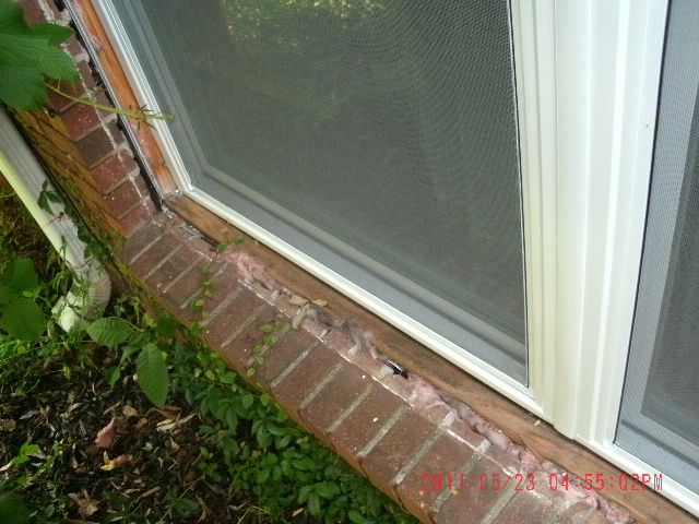

Phillip Posted May 24, 2011 Report Share Posted May 24, 2011 Owner installed window. say he has the molding to go around the window. Click to Enlarge 86.54 KB Click to Enlarge 61.53 KB Click to Enlarge 63.55 KB Click to Enlarge 65.76 KB Link to comment Share on other sites More sharing options...
AHI in AR Posted May 24, 2011 Report Share Posted May 24, 2011 What is that-- a vinyl replacement window slipped into a frame from an old wood window? Link to comment Share on other sites More sharing options...

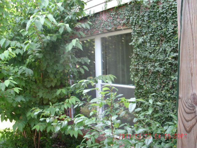

Phillip Posted May 24, 2011 Author Report Share Posted May 24, 2011 Here is what the other windows look like Click to Enlarge 78.21 KB Link to comment Share on other sites More sharing options...
Jim Baird Posted May 24, 2011 Report Share Posted May 24, 2011 Before he fetches the molding he needs to apply the lopping shears. Link to comment Share on other sites More sharing options...
Tom Raymond Posted May 25, 2011 Report Share Posted May 25, 2011 Before he fetches the molding he needs to apply the lopping shears. ...to his tool bag. The guy has no clue. Link to comment Share on other sites More sharing options...
Les Posted May 25, 2011 Report Share Posted May 25, 2011 I have seen this style installation several hundred times. Very common in our area. Jamb extensions and plenty of good quality caulk. Often backer rod is required to save on the caulk volume. Link to comment Share on other sites More sharing options...
Bain Posted May 25, 2011 Report Share Posted May 25, 2011 I have seen this style installation several hundred times. Very common in our area. Jamb extensions and plenty of good quality caulk. Often backer rod is required to save on the caulk volume. They do the same thing here, only they cover up the yuck--and usually the lintel--with trim coil. I always tell people I have no idea whether water is seeping behind the aluminum. Link to comment Share on other sites More sharing options...
