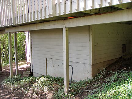

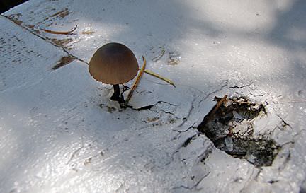

Ken Meyer Posted May 20, 2011 Report Posted May 20, 2011 This deck was toast. Rotted beams, joists, deck boards, railings, and the middle post had settled, but the owners were not ready to give up on it. Guess they used the orange shim (I think it's a splitting wedge) to take care of the bounce. Several large conifers that drop needles year round guaranteed that the deck would fail, no one would ever keep up with cleaning those needles out all the time, especially in winter. Click to Enlarge 42.98 KB Click to Enlarge 26.18 KB Click to Enlarge 26.62 KB
