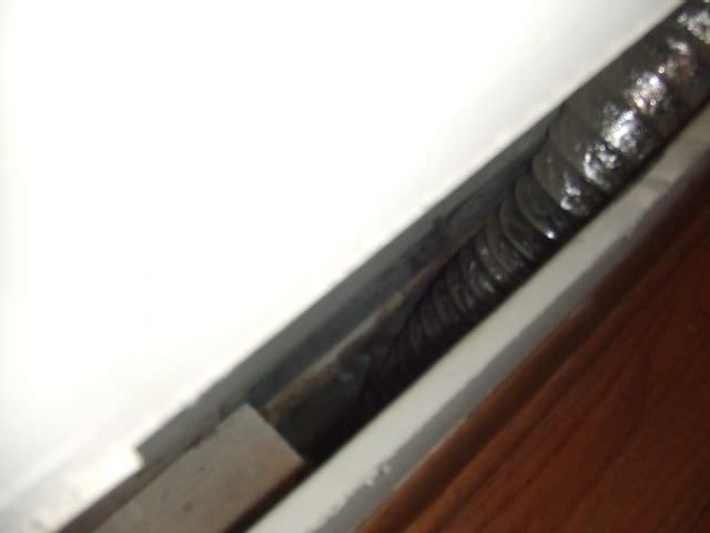

Scottpat Posted May 11, 2011 Report Share Posted May 11, 2011 Next time you see an HVAC register cover on the kickplate of a kitchen or bathroom cabinet you might want to take a closer look. At an inspection today on a new home I decided to remove the cover and I found the air duct hole under the cabinet. I have found this several times with new homes and on many pre-owned homes. The builder told me that is how they do all of their homes. Click to Enlarge 42.48 KB Link to comment Share on other sites More sharing options...
Terence McCann Posted May 11, 2011 Report Share Posted May 11, 2011 I see that all the time around here - it's never hard ducted. Bigger fish to fry. Edit: I just caught myself in one of those complacent moments. It's done all the time but it doesn't make it right. It wastes a lot of energy turning the cabinet into a plate warmer. Link to comment Share on other sites More sharing options...
Mike Lamb Posted May 11, 2011 Report Share Posted May 11, 2011 Same here. Never ducted. The air flow is usually poor but, "it's just the way we do it." Link to comment Share on other sites More sharing options...
palmettoinspect Posted May 12, 2011 Report Share Posted May 12, 2011 See that all the time here. Once did a house that recently had the bathroom remodeled and the contractor forgot to cut out the register. The duct just terminated under the cabinet. While inspecting the crawlspace I pulled back the insulation and the floor was soaked. I first thought one of the whirlpool jets was leaking. Link to comment Share on other sites More sharing options...
mthomas1 Posted May 12, 2011 Report Share Posted May 12, 2011 Once or twice a year I catches a kitchen or bathroom cabinet they failed to even cut the opening in the toe-kick - shows up nicely on IR. Link to comment Share on other sites More sharing options...
mgbinspect Posted May 12, 2011 Report Share Posted May 12, 2011 Next time you see an HVAC register cover on the kickplate of a kitchen or bathroom cabinet you might want to take a closer look. At an inspection today on a new home I decided to remove the cover and I found the air duct hole under the cabinet. I have found this several times with new homes and on many pre-owned homes. The builder told me that is how they do all of their homes. Click to Enlarge 42.48 KB In all honesty, I've never seen a builder do it any other way. Sad, maybe, but true... Link to comment Share on other sites More sharing options...
kurt Posted May 12, 2011 Report Share Posted May 12, 2011 This has been written up in a lot of builders rags; it's epidemic. It's even got a name......"plenum vented", or something like that. The plenum being the base of the cabinet. Honestly, if the base is clean, it's not that big a deal, it can work OK, it's just cheesey. If I had to get "caught" on something, i hope it's something like this. Link to comment Share on other sites More sharing options...
Jim Katen Posted May 12, 2011 Report Share Posted May 12, 2011 It's done that way in 99% of the houses I see. It's a problem when the cabinet is against an exterior wall and there are oversized holes for the plumbing pipes. Or when there are holes that lead into the crawlspace. Lots of heat gets wasted that way. Link to comment Share on other sites More sharing options...
Brandon Whitmore Posted May 12, 2011 Report Share Posted May 12, 2011 It's done that way in 99% of the houses I see. I was writing this issue up in new construction for quite a while, but finally just started to ignore it. Link to comment Share on other sites More sharing options...
Scottpat Posted May 12, 2011 Author Report Share Posted May 12, 2011 I have seen it for years as well, but I still write it up. I guess it bugs me the most simply because the air can not be regulated at that register. It goes back to my old energy rating survey days. This was at the end of the trunk line and the air was about half as strong at the other registers on that same trunk line. Link to comment Share on other sites More sharing options...
blindrid Posted June 28, 2011 Report Share Posted June 28, 2011 It's done that way in 99% of the houses I see. I was writing this issue up in new construction for quite a while, but finally just started to ignore it. Agree as almost 99% of the homes also do not have balanced systems so it is a moot point. I think those that are writing it up are wasting paper and the client's time. Link to comment Share on other sites More sharing options...

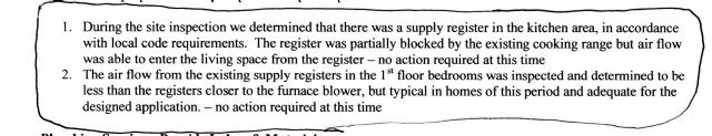

Anatol Posted July 1, 2011 Report Share Posted July 1, 2011 During a re-inspection yesterday, this document was provided to my client by the seller's hvac contractor. I had reported low flow to the bedrooms and no heat source in the kitchen. There was no change at the time of the 2nd inspection. I was unable to feel any air movement from under the dishwasher or the stove which block the supply in the kitchen. Click to Enlarge 28.02 KB My client said that was BS. I suggested that she have the system properly balanced and the supply repaired in the kitchen. Closing was scheduled for today... Anatol Link to comment Share on other sites More sharing options...
John Dirks Jr Posted July 4, 2011 Report Share Posted July 4, 2011 During a re-inspection yesterday, this document was provided to my client by the seller's hvac contractor. I had reported low flow to the bedrooms and no heat source in the kitchen. There was no change at the time of the 2nd inspection. I was unable to feel any air movement from under the dishwasher or the stove which block the supply in the kitchen. Click to Enlarge 28.02 KB My client said that was BS. I suggested that she have the system properly balanced and the supply repaired in the kitchen. Closing was scheduled for today... Anatol Rest assured, you did your job. Based on the HVAC contractors comments, they bought the problem. Link to comment Share on other sites More sharing options...
