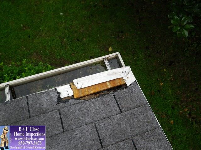

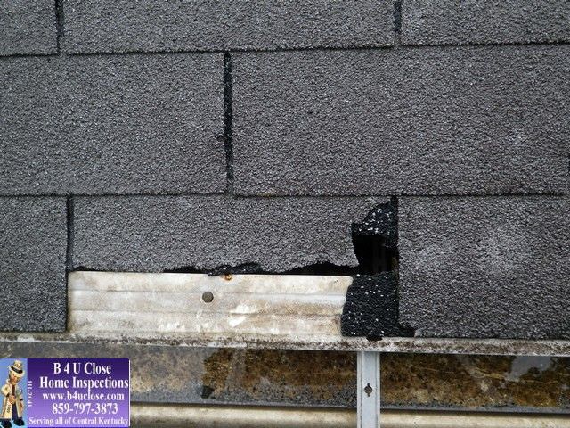

Erby Posted May 3, 2011 Report Share Posted May 3, 2011 I hate that "further evaluation" crap and stay as far away from it as I can. They hired ME to evaluate it. Like above, it's flat. Fix it or run on a flat tire. Like these two pictures. No need for further evaluation. Just have the damn roof fixed. Click to Enlarge 118.4 KB Click to Enlarge 71.49 KB When I have to it's: Here's the problems I see. Here's why they are a problem Talk with a xxxxxx contractor to determine all necessary repairs & best repair method, to estimate costs, and to perform any repairs deemed necessary. - Link to comment Share on other sites More sharing options...
