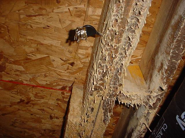

hausdok Posted March 4, 2005 Report Posted March 4, 2005 There's a fungus amongus! [:-magnify Click To Enlarge
rlskfoster Posted March 4, 2005 Report Posted March 4, 2005 man that looks nasty! I think I would want to shoot that picture with a zoom lense. It almost looks like spilled paint that dried. What is it? Buster
rlskfoster Posted March 7, 2005 Report Posted March 7, 2005 So if I was to run across some Poria Incrassata What can you do for it. Is this a serious problem or can it be fixed easily. Buster

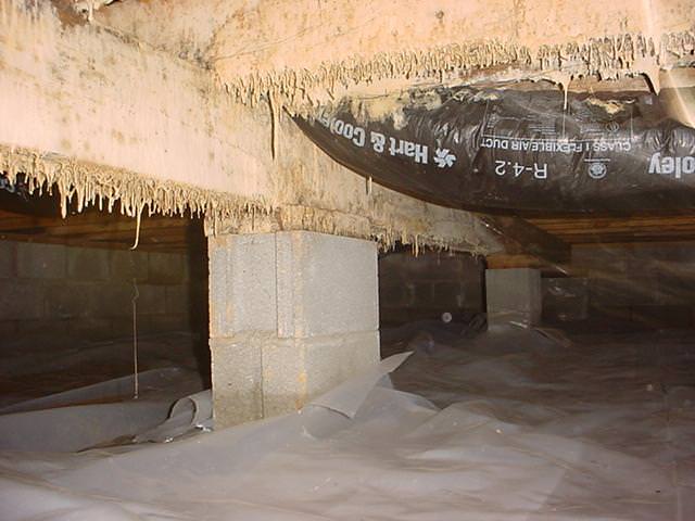

Erby Posted March 15, 2005 Report Posted March 15, 2005 I thought I recognized that photo. Here's some more photos of that same crawl space. It's located in Marion County, Kentucky. Good reasons for PPE. How'd you get the photo, Mike? I've had the original posted on my cockmamie photos page since last year and sent it to several "mold experts" to see if they could identify it. This guy finally helped the most, but still couldn't come up with a specific name for it, other than some type of brown rot, just based on the photo. Fungal & Decay Diagnostics, LLC Harold H. Burdsall, Jr., Ph.D. 9350 Union Valley Road Black Earth, WI 53515-9798 Phone: 608-767-3930 FAX: 608-767-3920 Email: burdsall@fungaldecay.com Web Site: www.fungaldecay.com
Erby Posted March 15, 2005 Report Posted March 15, 2005 OK, so I had to fix my cookie setting before I could upload photos. This was back on the 31st of May, 2004. Download Attachment: Slightly different view. 48.02 KB Download Attachment: The Key! 67.26 KB Download Attachment: Other Gunk 43.65 KB Download Attachment: DSC09995.JPG 53.32 KB I wonder why my buyer decided to move on.
rdrosd Posted May 13, 2005 Report Posted May 13, 2005 Ran across a case of poria a couple of years ago. I will attempt to upload some pix. Notice the ryzomorphs that come up from the ground. These are the roots that bring the moisture to the wood.
