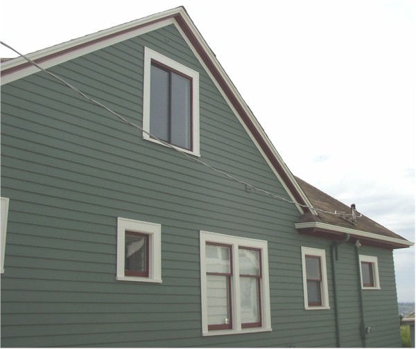

Robert Jones Posted April 15, 2011 Report Posted April 15, 2011 Yesterday's inspection. Service lateral was approx a foot from the window opening with the mast head enclosed in metal/vinyl wrapped eaves. Click to Enlarge 71.79 KB Click to Enlarge 32.87 KB

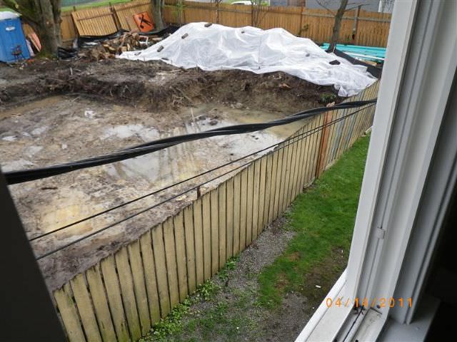

Richard Moore Posted April 15, 2011 Report Posted April 15, 2011 Had something very similar at my own house. It wasn't in the inspection report. Download Attachment: 6253 1st 002x.jpg 56.66 KB It wasn't a bedroom at the time, and I don't have children, so even though I later discovered that it was a no-no, I decided to live with it knowing we would eventually be remodeling. About 3 years ago, or 15 years after we bought the place, it finally got moved. Download Attachment: Sept 7th-052x.jpg 277.56 KB The utility company has since cleaned up the temporary connections. But, yes, potentially very hazardous and a good call.
Tom Raymond Posted April 15, 2011 Report Posted April 15, 2011 I just drove by a place like the one in the OP. The utility came by and put an insulated cover on the lateral, nice fix-I wish I had my camera with me.
