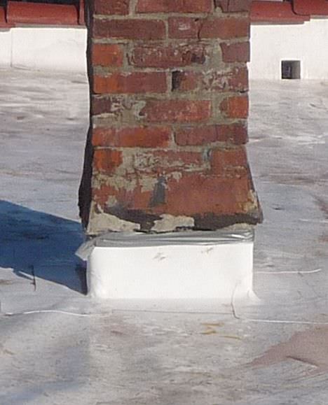

The last one I got asked to do was for a "flat" roof with tiled parapets that had a new TPO covering. The listing agent/seller had fessed up to my client that the work was not up to snuff but that her roofer wasn't responding to her complaints. Evidently, there had been a previous inspection. So, at the same time as my inspection the agent/seller had another roofing company (a well known one) inspect the roof. I basically just followed him around, reported the more obvious stuff to my client (also an agent), but deferred to the roofer and suggested she get the resulting work order and warranty from him or the seller. We were both under the impression that this new company was going to make the many needed repairs.
As it turned out, the agent/seller went back to the original guy, presumably armed with the list, and forced him to do the work. Keep in mind this is the same genius that thought that duct tape was an appropriate way to flash a chimney!
Click to Enlarge
47.09 KB
A couple of weeks later my client wants me to re-inspect the roof and tells me the story of who did the repairs. She also said that the guy was offering no warranty at all on his work (original or subsequent "fixes"). I had no problem at all turning her down and, instead, recommended she get an independent licensed roofer to do the inspection, preferably the one who had done the original write-up.
