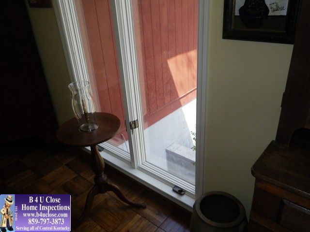

Jerry Simon Posted April 11, 2011 Report Posted April 11, 2011 I probably got this wrong, but one of things that says a low-to-the-floor window pane requires safety-glazing is if the pane has an area greater than nine square feet. Assuming that's right. . . I saw some 33" by 35" low windows the other day (<10" above the floor), and the muntin bars were not installed. Without the muntins, the panes looked HUGE. My client has toddlers. I recommended changing the glass to tempered glass, regardless of any rules or guidelines. Any thoughts/comments?

Jerry Simon Posted April 11, 2011 Author Report Posted April 11, 2011 Here's a pict of what concerned me. . . Click to Enlarge 55.19 KB

inspectorreuben Posted April 11, 2011 Report Posted April 11, 2011 If you're concerned about someone getting hurt, you could recommend they coat the windows with http://www.3m.com/product/information/Scotchshield-Ultra-Safety-Security-Window-Film.html. - Reuben
gtblum Posted April 11, 2011 Report Posted April 11, 2011 Even if I see safety glass, I write something like this. The (your window here) windows are very close to the floor. I strongly recommend some type of safety barrier of a material that could be easily breached by a fire fighter, be installed to prevent a child from falling into or out of these windows.
kurt Posted April 11, 2011 Report Posted April 11, 2011 I'd probably say something about it. I have in the past when I've seen similar things. My comments were always along the lines of ....... "The windows are close to the floor; your kids could smash against them and be injured. Install a barrier or replace the windows with safety glazing."
Erby Posted April 11, 2011 Report Posted April 11, 2011 Not safety glazing. Long drop to the ground below. Click to Enlarge 40.19 KB
